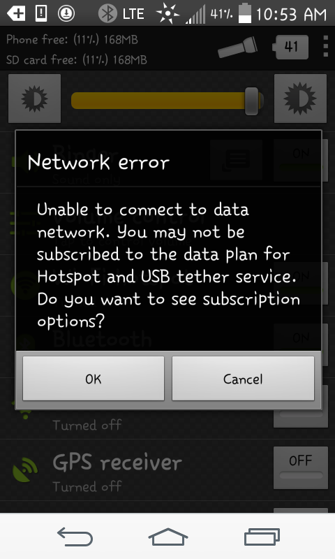

Thanks! The main thing I'm trying to do is use my hotspot/tether FREE. All apps I've tried from the play store shows me this message(see attachment)
I'm familiar with that message. You can go at it for free, but you do so at your own risk. As I said on another thread you're on, the provider might pick up on what you're doing, and block your account.
