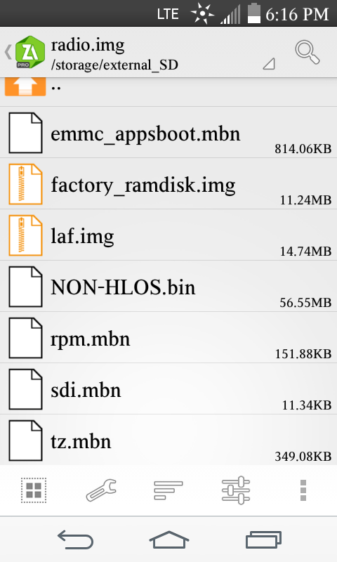

This ought to be fun. I also found in system/firmware/ files that relate to manufacturer keys, they're encoded, but I don't know in what way. I did manage to open it in notepad, most things were unreadable, however, but I looked through what was anyways, and discovered references back to the radio.img. So I grabbed it out of the zv6 update, tried unpacking it, no dice, so on a hunch tried opening it as a zip, and got this...(see attachment) I believe we could find another exploit with the info in these files.
radio.img is just a zip containing images to some partitions. I am not 100% sure, but I think:
emmc_appsboot.mbn => aboot (bootloader)
factory_ramdisk.img => factory (with minios3, seems to be the kernel/ramdisk used for the factory test within the hidden menu)
laf.img => laf (download mode)
NON-HLOS.bin => modem (a vfat volume mounted at /firmware; probably modem firmware)
rpm.mbn => rpm (ELF binary)
sdi.mbn => sdi
tz.mbn => tz (ELF binary; maybe used to write to Trusted Zone?)
It seems only NON-HLOS.bin is mounted after boot. The other ones are probably used for booting and device maintenance. When an update is being installed by the stock recovery, it seems radio.img is treated differently than the other parts like system files, boot.img, recovery.img, etc. Unfortunately, I don't know whether it's safe to manually write to any of these to the partitions.

This is exactly the kind of info I was looking for, specifically this part; "emmc_appsboot.mbn => aboot (bootloader)". This is definitely where I need to be looking if this is true. Thank you!
Edit; On second thought, tz.mbn is also worth checking out.
