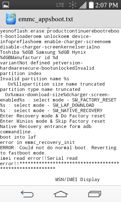

On some other devices, you can get fastboot by zeroing out the laf partition. Apparently, when aboot tries to load laf to enter the download mode but fails, it falls back to fastboot. So once in fastboot, the bootloader could be unlocked if it doesn't require some key. I have no idea whether this works for the Tribute with Sprint/VM though.

I think you're right about fastboot. Check this out. Especially the last several lines...

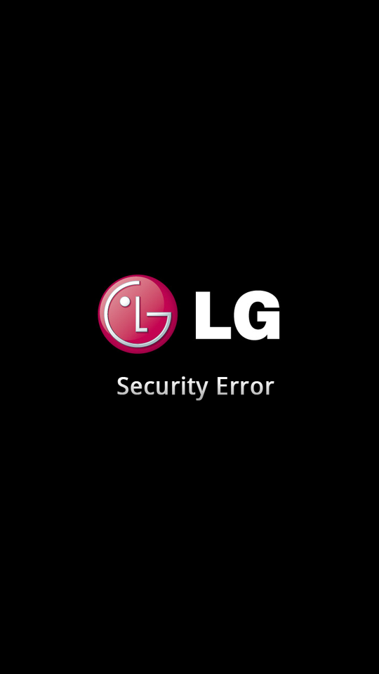

TWRP still works, and will still install on ZV6, but a bumbed boot.img won't. It always gives me a security error. Deodexing stock ZV6 will give me the same error, even with the stock boot.img. My only guess is that there's now multiple signature checks in place, or at least 2 rather, one for system apps, and another for the boot image. If anyone else has a working ZV6 deodexed, I'd love to try flashing it just to confirm it isn't somehow my own error that's causing it.

Since TWRP can boot, the bump key must still work to bypass the bootloader's signature check. I don't know what the security error looks like, but my guess is the error is coming from the kernel because some system files don't pass SELinux's permission checks. As far as I know, there is no change between boot.img of ZV5 and that of ZV6, other than some version number change(s). I've never studied deodexing, but I thought deodexing is applied only to system apks? If so, you should be able to use the boot image of SuperR's ZV5 rom (with his permissioin) as a base.
Yeah, Deodexing applies to the system apps. I honestly don't know what the cause is at this point. All I can tell you, is the following...

Edit: Pic of the screen that bootloops forever.

OK. I don't have all the information. There's a lot of guess work on my part, but I hope the info can provide you with a clue. Hopefully this is not too off-topic, or maybe we need a separate thread for further discussions.
TWRP is a bumped recovery image. So the security error is not coming from the bootloader. The image you posted looks exactly like /res/images/errorlogo.png. That's inside the kernel ramdisk (in the boot image). If we search for "errorlogo" within the ramdisk files, we see the only reference comes from /sbin/wallpaper. Peeking inside "wallpaper," we see some text about security and crypto. So it's likely that's where security checks occur. Next, search within the ramdisk to see how "wallpaper" gets invoked. We see this line "exec /sbin/wallpaper -ap" in "/init.lge.rc". If we check "init.lge.rc", we see the comment "#CAPP_SECUREBOOT" right above the "wallpaper" line. So there it is. A big neon sign. Now, I don't know if that's all there is, but start by commenting out "exec /sbin/wallpaper -ap" or by removing "/sbin/wallpaper" to see where you'd get.
