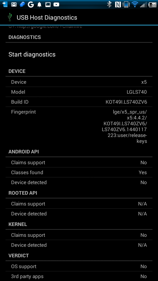

The app "USB Host Diagnostics" from chainfire says our device doesn't have support even with your kernel. I tried again to plug my mom's iPhone 4s (should work right?) into my LG Volt. https://play.google.com/store/apps/details?id=eu.chainfire.usbhostdiagnostics
