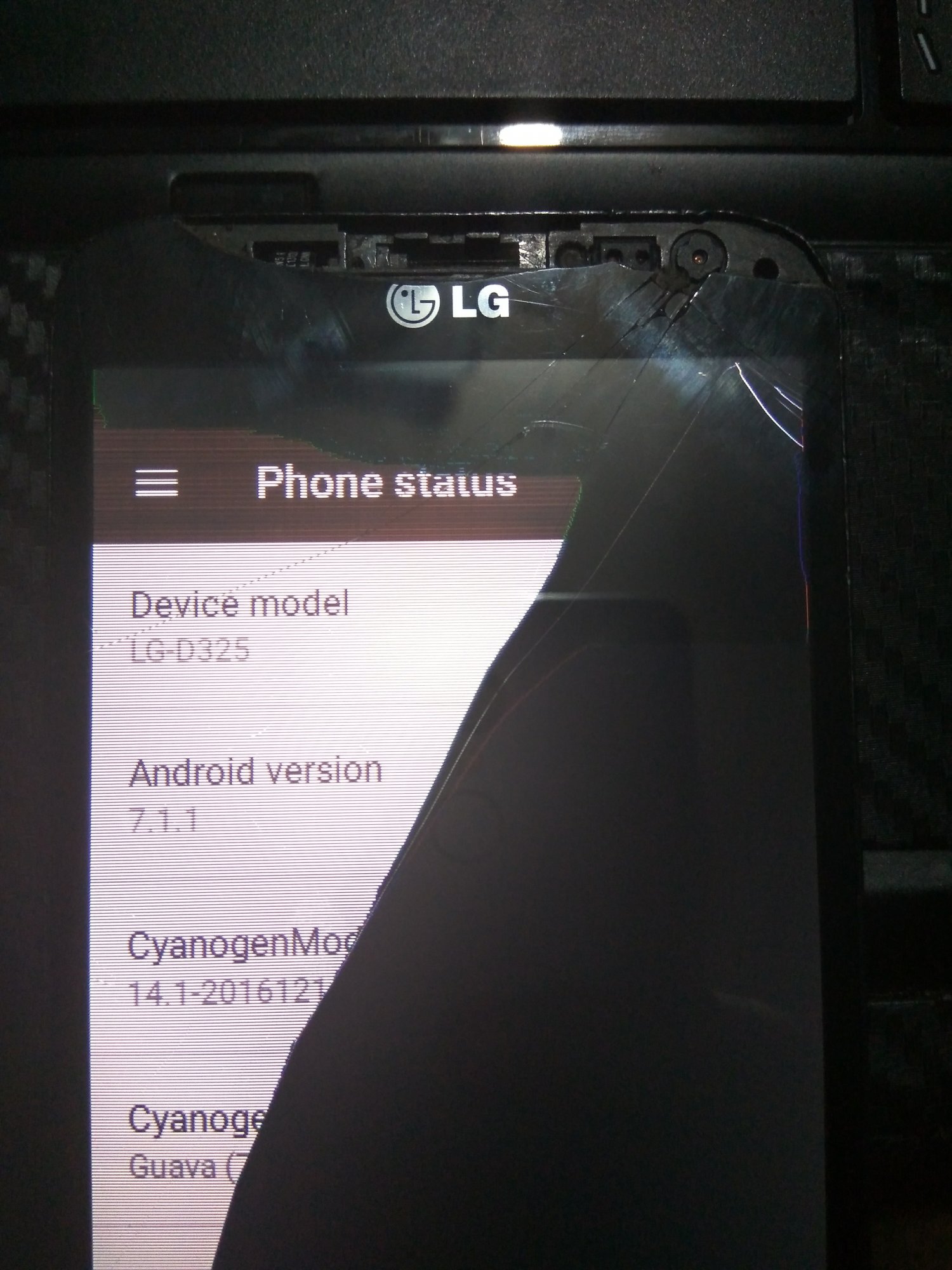

Unfortunately, the Nougat update didn't fix my broken display panel
What a tragedy, man!:(
Maybe you can still find the Front with Screen and Display for purchase. Plug 'n Play
This happened to me a year ago, only the touch screen broke. But the plastic edge has damaged, right at the top right of the Smartphone. So I decided to buy the entire front with display.
Finding replacement parts here is hard. Luckily the touch screen is still responsing. I use it now as a wifi hotspot since I got a new phone.
