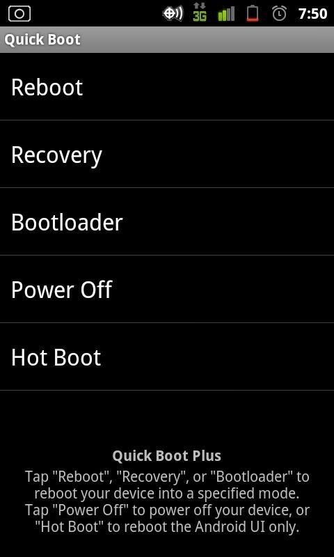

Use titanium back to boot to recover or a program called quick boot from Google play store
https://play.google.com/store/apps/details?id=com.siriusapplications.quickboot&hl=en

I have Quick Boot installed from the app store but the problem I'm having is that it shows a white triangle with a yellow exclamation mark, and a green bot just below it and stays on that screen. So, you think bringing up a command window with "ADB Reboot Recovery" will get the job done? Appreciate the help and advice.:)
