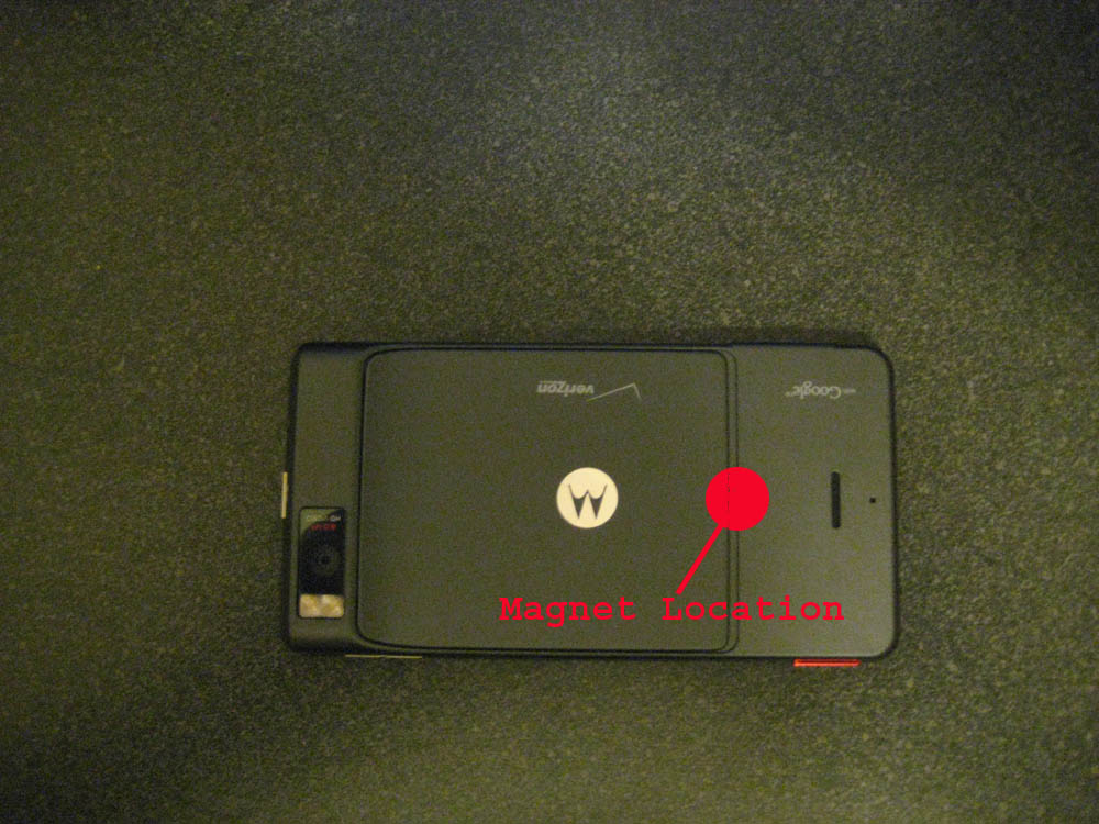

On the back right around the speaker where the battery door edge is.

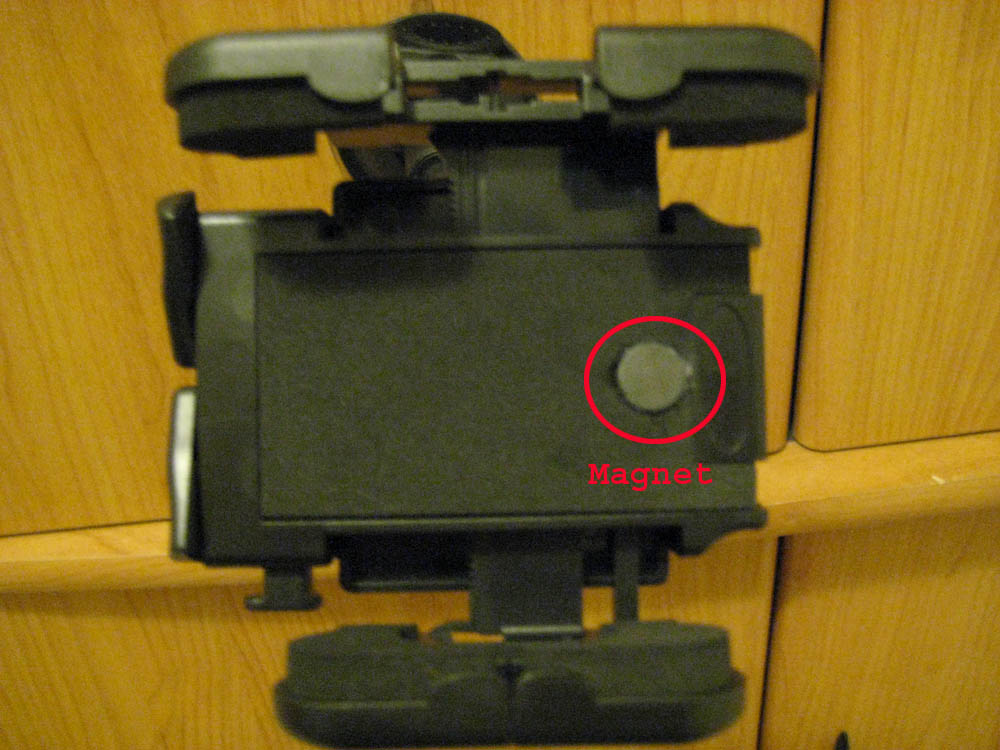

Long time lurker, first time poster. I recently got the Droid x for work and wanted a car mount. I got a cheap suction cup/vent mount from Fry's electronics for $15. I then got some fridge magnets (clips) from the dollar store. Hollowed out a spot in the foam backing of the mount and placed the magnet. It now goes right into dock mode as soon as it is in the mount. I also realized if I reversed the magnet it switched to the desk dock mode. Same magnet position different polarity

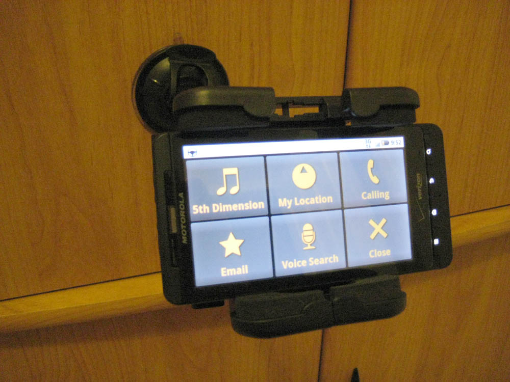

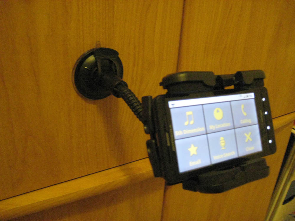

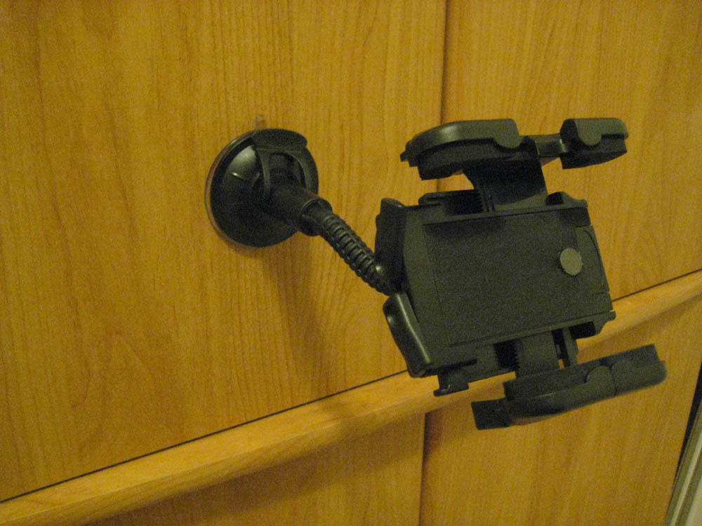

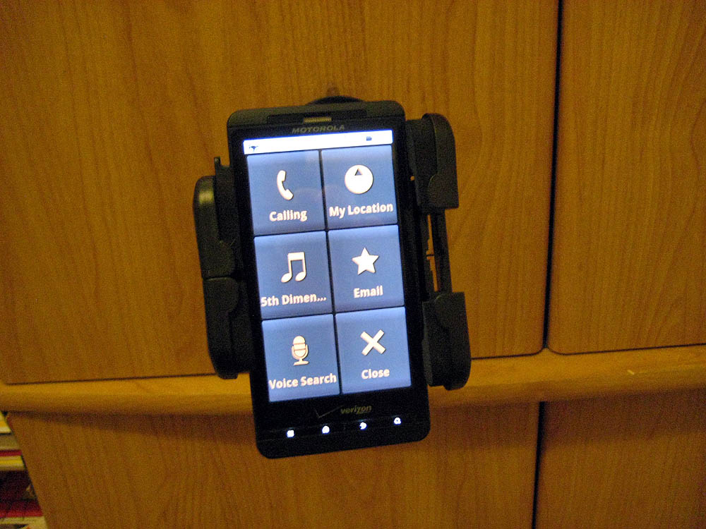

I took some quick pictures. Hope the upload works. I attached to my fake wood tv cabinet in my office. You can see the magnet is not completely flush as it was pretty thick to begin with. Once I get a case for the phone I won't be worried about it rubbing.
I'm hoping to figure a way to thread the power cable permanently into the stabilizing arms in the future
