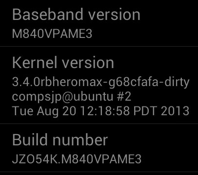

Will this kernal work with new mh5 update cuz it keeps popping up on the phone and its getting annoying but I don't want to risk updating software again and risk it bricking one more time went thru geek to recover
it'll work. just dont take the mh5 update over the deoxed rom or it will bootloop. Everything on the forums should be compatible with everything availiable on this device.
Actually, the mh5 update will fail it's assert test and cancel installing if you have deodexed, removed system files, changed recovery, or changed kernel.
If you look in the updater-script in the zip, you can see where it checks the md5sum on almost everything before it installs.
The best option would be to use odin to put in the stock MH5 image, then root it, remove the recovery-from-boot.p file from /system, install CWM again, and then flash your custom kernel
I tried flashing the mh5 with Odin and it doesn't wanna work it fails and I tried to install zip in recovery but it aborts installation
I don't think I am cuz I flash the kernel no problems I opened Odin clicked pda chose the file clicked start it begins checks md5 sums setup connection.... stays for a few mins like that's n skips thru with fail...After something days bad file
