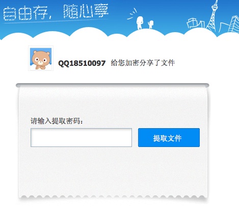

Did you see a page like this....
Put "cbhh" in the box, that's the password, and press the blue button.

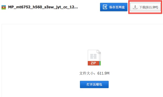

Then you should see this, top right button is the direct download to your computer.
BTW you're trying to do this on a mobile device, Baidu will prompt you to install their Pan file sharing and downloading app. You have to use a desktop browser to download it directly.
