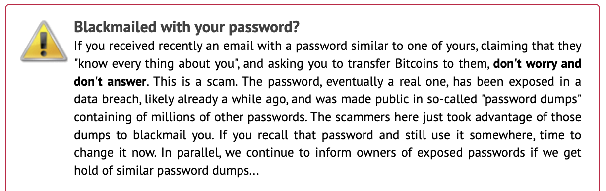

That sounds a lot like a well-known scam. I received a couple of those last year, though in my case neither included a password (plus the claims they made could not be true in my case). But one of the current variants on this is to include a password obtained from a breach of some website as "proof" of authenticity.
For example, the CERN single sign-on page currently includes this warning, which sounds very similar to what you describe.
