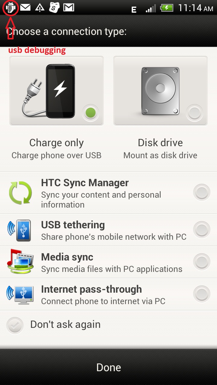

i know you cant check it now,but the setting were refering to is settings/developer options/usb debugging. hopefully youve had to checkmark that setting for some other program or app to work,as its not usually on by default.
if you allready have the sdk set up,all you need to do is plug in the phone,youll see the usb debug and charge icons pop up in the status bar.

if you DONT happen to have the sdk set up,no biggie,you dont need to fool with the whole thing. we have a much smaller download,youll just need to extract,open a cmd window and change to the correct directory. just let us know if you need this :)
