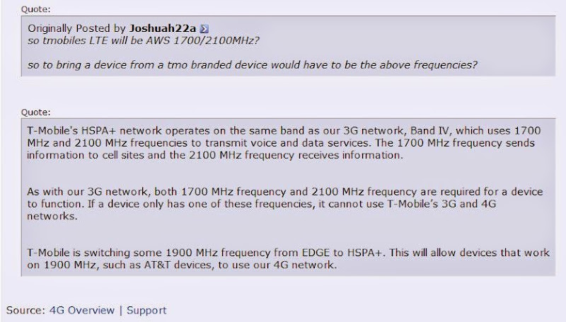

so tmobiles LTE will be AWS 1700/2100MHz?
so to bring a device from a tmo branded device would have to be the above frequencies?
T-Mobile's HSPA+ network operates on the same band as our 3G network, Band IV, which uses 1700 MHz and 2100 MHz frequencies to transmit voice and data services. The 1700 MHz frequency sends information to cell sites and the 2100 MHz frequency receives information.
As with our 3G network, both 1700 MHz frequency and 2100 MHz frequency are required for a device to function. If a device only has one of these frequencies, it cannot use T-Mobile
(Iamsirlurkalot the way you added the T-Mo quote made it IMPOSSIBLE to quote your post. I had to <Major PIA> snip the whole damn thing. :( )

If the above is twue, (and yes it's from TMo paperwork) then how does Current T-Mo S3 work on T-Mo's LTE? According to this, it only has ONE of the required frequencies, not Both. (The below are it's bands C/P from the T-Mo website)
Band (frequency): UMTS: Band I (2100);UMTS/HSPA+: AWS Band IV / 2100 / 1900 / 850;Band II (1900);Quad Band GSM;LTE
According to this, it's missing the 1700 band. How can it work on ALL the current T-Mo LTE network then?

AWS uses 2 frequencies 2100 for DL and 1700 for UL, 1700 is used for the band 4 identification which is AWS so 1700/2100
EDIT: Wrote ^^^ pretty badly, Bruce look at the specs again it tells the actual band frequencies for the others(1900 & 2100) but when it's talking about Band IV it has AWS in parenthesis not band numbers because AWS corresponds to both 1700 & 2100MHz. That's why it's AWS 1700/2100MHz
