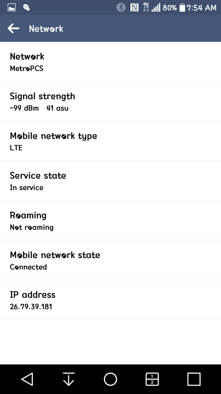

I had done this method about a week ago and tested it out b4 i upgraded my better halfs day b4 yesterday trust me it works if it were not for @DrakenFX i wouldn't have tried it ty vm

I did this method and it did indeed work flawlessly. Im using the metro variant on 6.0 MM.
I have some complaints but not about the process or anything related to the good work everyone has done to get us here.
My complaints are tmo/software related. Some things are wonky when using the tmo Rom on metro.
