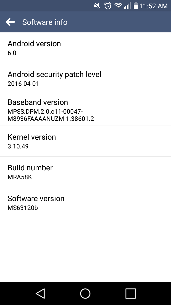

Is there anything I should know about flashing a Tmobile kdz file to a Metro PCS phone besides this? Like will my phone still work okay? Or do I have to get updates from tmobile from now on?
It worked thank you

hey thank you very much i used this page and it help me very much and i now have marshmello
