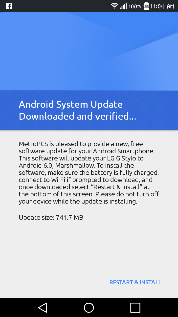

Woke up to this seems official. Questions... Upon receiving my phone I rooted lp 5.1.1 with king root and flashed twrp succesfully ...right after root I backed up Rom with bloatware. I later found katana Rom so I flashed it successfully to my surprise it came with su root over king root I was surprised but works perfectly. Now my question is if I flash my 5.1.1 rooted backup could I apply update over it or do I need to be bone stock? I ask because I remember android system was able to apply update over root as long as all original apps were installed so need to know if this still holds true. tia
Nope, have to go back to complete stock, even if you haven't deleted any apps the root binaries are still there, it won't install. Also you need to have the stock recovery to take an OTA, so there's that as well.
