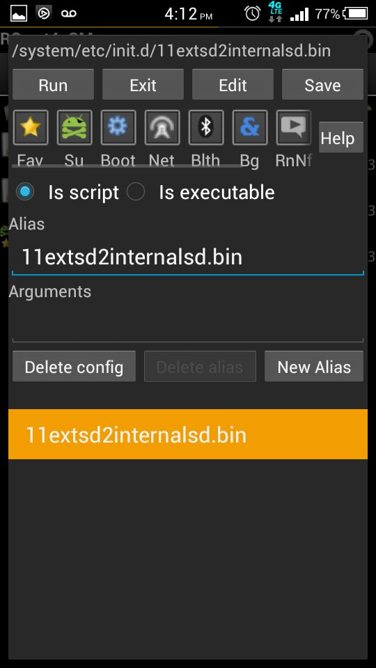

Mount as RW to be able to change stuff

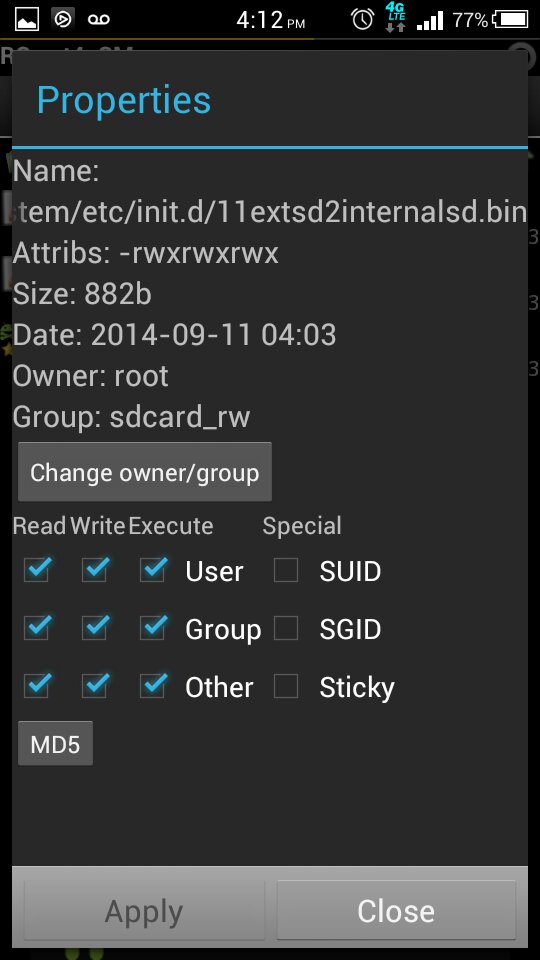

Find the script and place it on system/ect/init.d/ then paste it next will press the script until u see a menu then select /properties and click all of em it will give u a message that says something about u might brick ur device ..don't worry i have done it alot of times but like always its up to u and only up to u
Here is what it should look like
Next click the script again and u should see a different menu

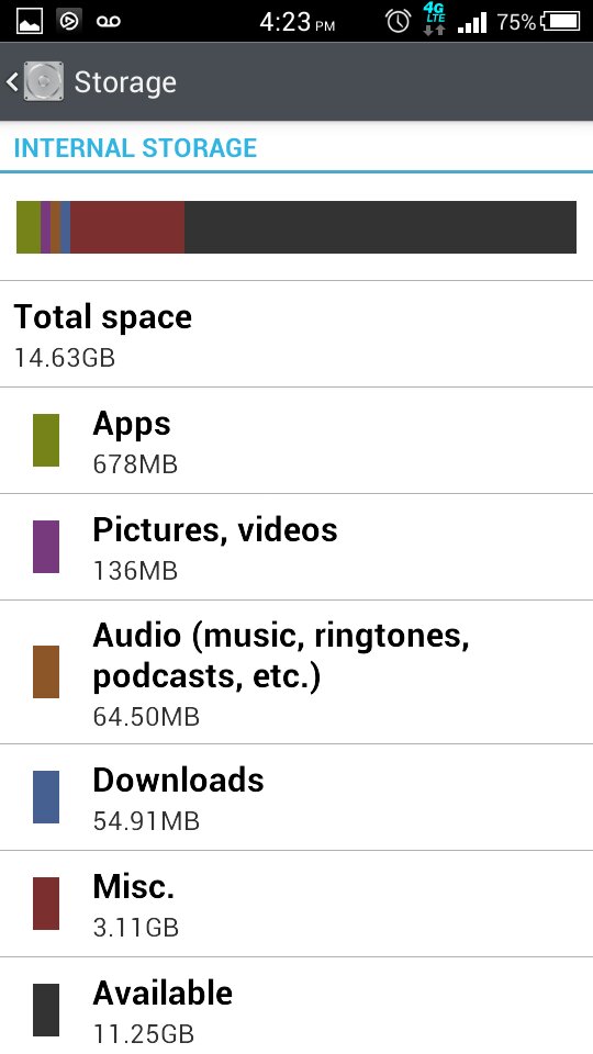

Now u should have ur SD fused! Congrats ^-^ mine is expanded to 16gbs. PS no need for partition !

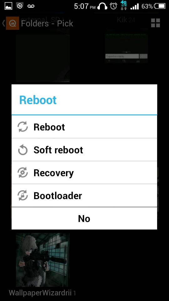

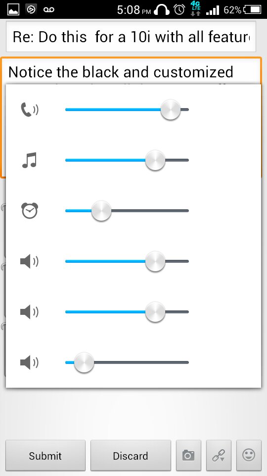

Notice the black and customized status bar also all the power off menu options and volume controls

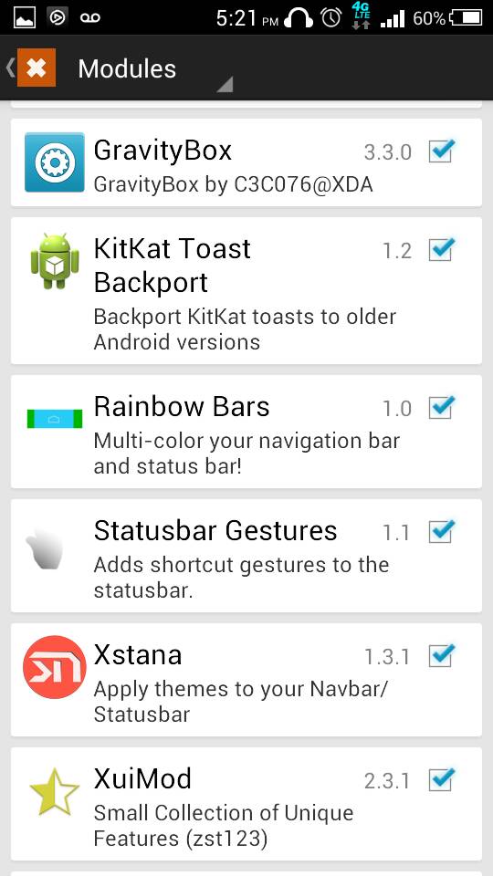

Here I'm using alot of modules, xstana,rainbow barz,xui mod,kitkat toast, gravity box just to name a few

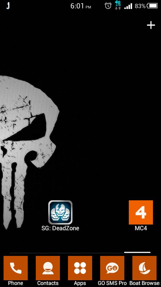

Yeah bro I have MC4, GTA, NOVA3,
It is why I stick with 10i over kitkat and cm11 ..anything u need .. pm me or ask me here bro I'm here to help

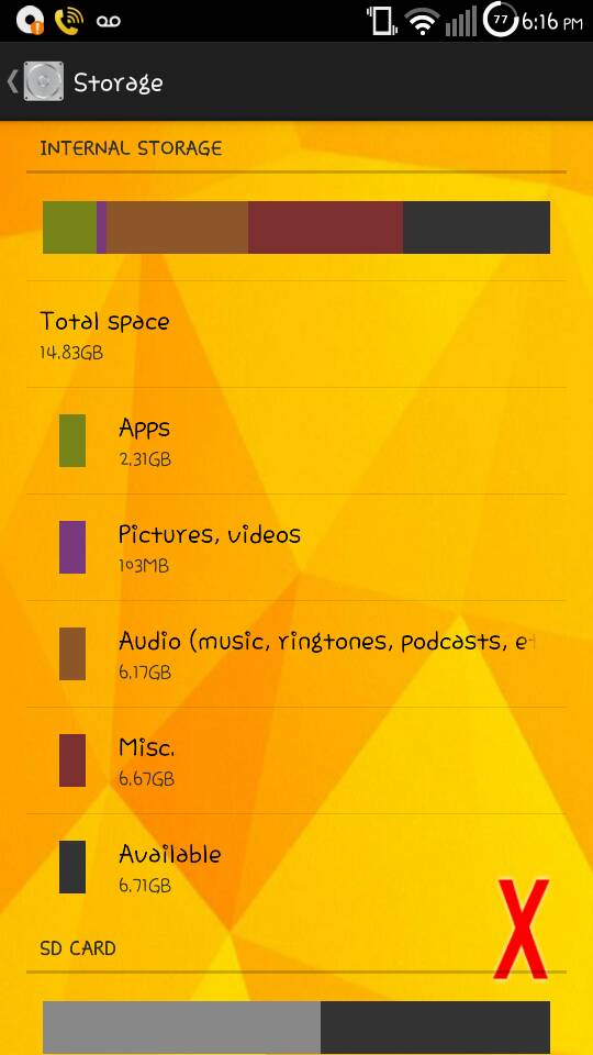

Idk maybe it doesn't work on 10b...see the photo?
But then again it could just be the app...ima try a different app this time
Lol look at the image again...if you see in the upper right corner there is a "storage is getting low" icon
Ah I see do a clean install factory reset it do the process again it will work trust me. In the pic u can see the mc4 and shadow gun both work flawlessly oh btw clear dalvik cache and cache partition
