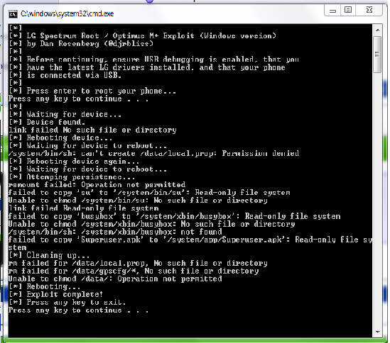

Root [MetroPCS & T-Mobile] My lgms695 OM+ will not root
says no file directory failed access denied i have done everything the guide says and tried to get as much info as possible tried motochopper and the one from this site i really am confused already factory reset phone and sd card and now im lost :( done the process over 100 times
i dont know the problem

That is info for an Optimus F3, not a M+. Looks like you may have confused the model #'s, 659-695. If you have an F3 this is the wrong forum, try the F3 forum.
http://androidforums.com/lg-optimus-f3/
And since we're already here, if it's an F3 running version c firmware motochopper won't work (and an exploit for an M+ won't either). Use Saferoot.
Good call Fox, thanks. OP, let us know which carrier you are on and we will get your thread moved to the best place to get an answer.:)
