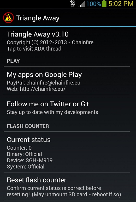

Mine is able to reset flash counter to 0. What are your settings?
I didnt change anything in the settings or anything. When I hit reset flash counter then it resets it the app closes I open triangle away again and it worked the counter goes to 0 but then when I restart the phone it goes back to 2. I checked download mode after doing triangle away and it stays at 2. Idk what I'm doing wrong
The reason for that is, you are still rooted with the su binary still in the phone. If you use triangle away, reset the couter than you can either open su and do a full unroot or power down the phone and boot into download mode and flash the stock tar file using odin.
