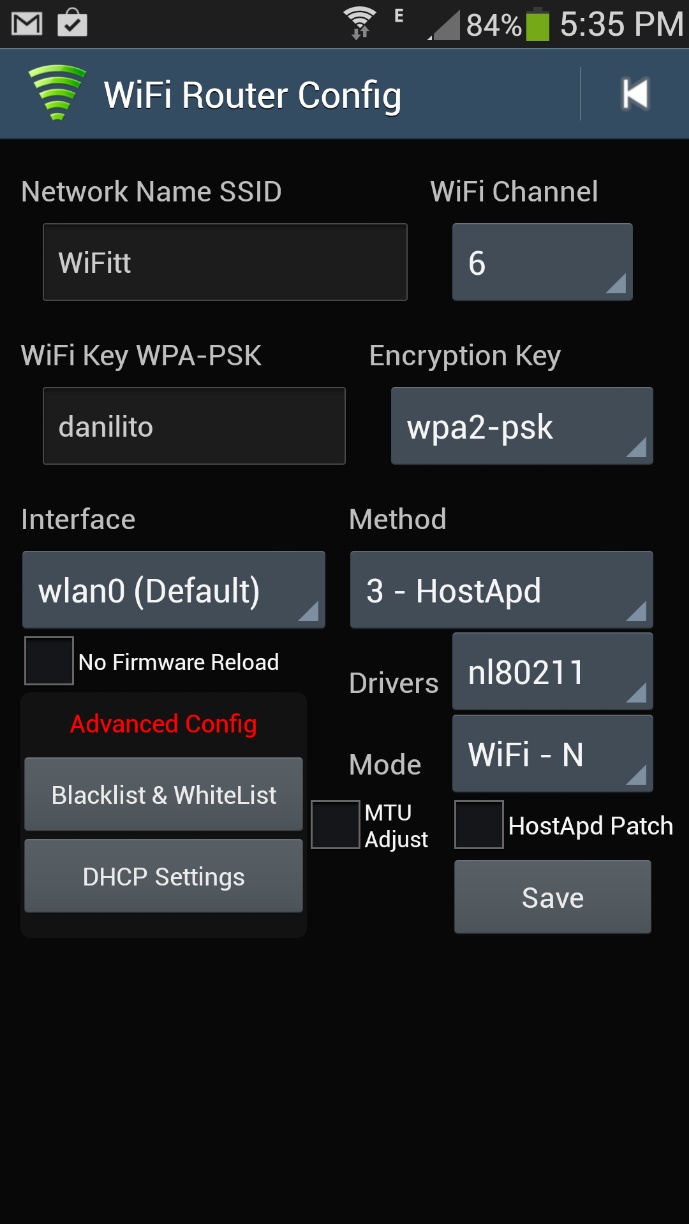

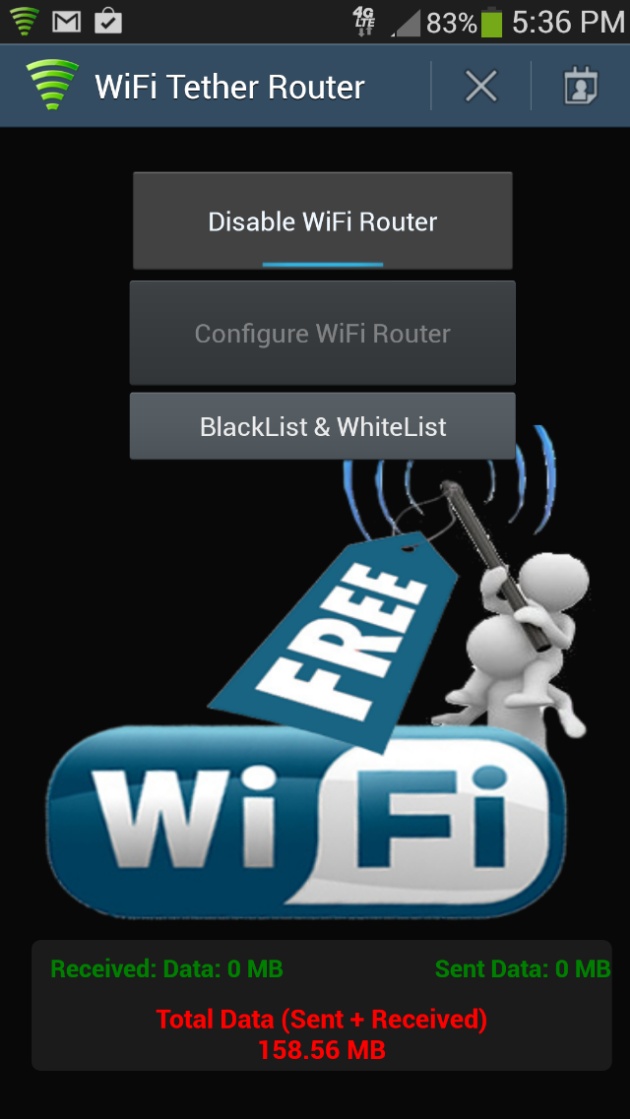

These are my settings and as you can see it works.
It works I did it for the first time last week. Follow dannyvw settings.
