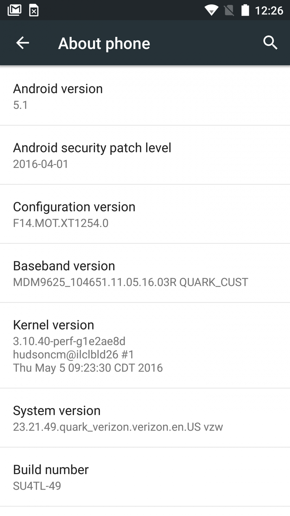

I have confirmed I do not have a hardware failure. My microphone works perfectly if I use the video recording camera. But after the Verizon security update 23.21.44 the microphone has never worked again, either within taking a live phone call or voice to text , or search voice to text. It has to be software conflict. This has forced me to activate a new phone earlier than I had wished. I've purchased my phones outright and not though Big Red. I need to get this settled because I'd like to sell the Turbo and stay with my new Nexus 6 for now.
Looking for answers.
Have completed the factory reset wipe N/G
Tryied safe mode too N/GG
Has anyone heard of this. I would think its a large group. Any info greatly appreciated!

Just though I'd try to update my original post about microphone lost after a verizon software update.
Since no one could hear
me, but I could here them, I had to get a new phone!
I switched to a Nexus 6.
Did not trust the droid build anymore due to this failure.
Anyway, I've kept the phone because I could not resell it due to it's failure.
Long story short... After regularly checking for updates every month or two ...It's been almost 1 year !
A NEW LATEST UPDATE HAS COMPLETELY FIXED THE MICROPHONE FAILURE ISSUE !
Unbelievable, I knew I was right about my software update microphone failure issue in the first place.
