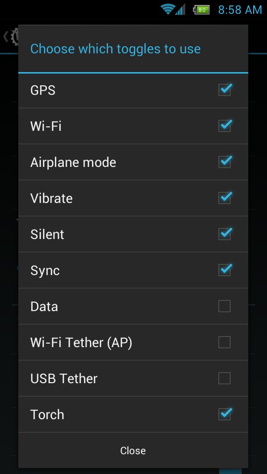

I don't know its me or some of toggles are missing like 4G and also what the hell is that purple hate (swag toggle) what does it do

Swagger work around ( only apply if your over 45, cauz you got none! :( )
System settings => ROM Control => Toggles => "Reset toggles" ( at bottom )
Seems I lost my swagger toggle :rolleyes:, can others recreate? :D
I turned on only the toggles I like and also setup "Brightness location" since that toggle is missing but the button and slider work better for me ( NOTE: that that "Auto" which is a button and slider to the right just above the toggles). Still missing 4G toggle. But it looking dam good!
