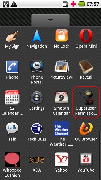

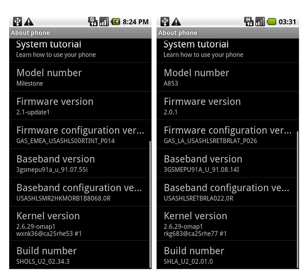

I tried another file, the Brazilian SBF one from this site (see link below) and it worked. I've got ROOT now, but it reverted back to v2.0.1. How do I bring it back to v2.1-update1 like I had before? I tried the Recovery file but that didn't work?
Click on my thumbnails below if you want.
Link: Root Telus Motorola Milestone on Android Platform Easily | Gadgets DNA
I didn't think the Brazilian SBF would work on the Chinese frequency bands. But as long as you were able to make a call, and you were able to get correct data speeds then you might as well use the Telus SBFs.
This means you might as well use the G.O.T. SBF. (http://groupoften.wordpress.com/). I think you should be able to go from your 2.1 SBF straight to the G.O.T. SBF.

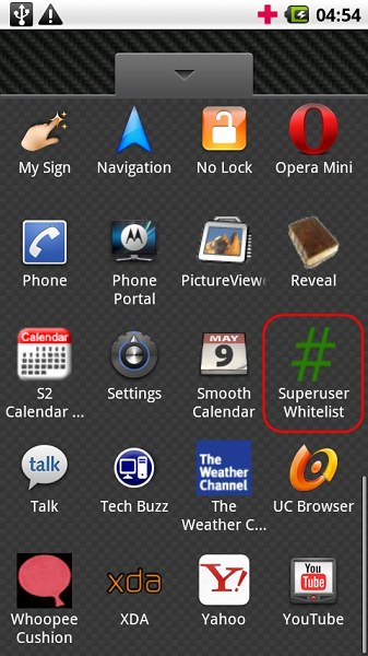

I got the G.O.T. loaded and it worked but I'm still with the old v2.0.1. I'm not really able to make a call though. It's runs intermittently and I keep getting these 'Sorry/Force Close' windows. I've got a new Superuser icon though.
OK,what do I do next?????
