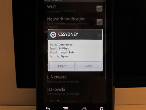

I am having the same issue. When I click on the AP that I am connected to, I see all the other info, but the line containing the IP address that is being talked about here is missing. I am running Android 2.1 on my Motorola Milestone (Telus).
Any thoughts would be greatly appreciated.
Cheers,
-f.
Here's some pictures. One is from the Android Wifi settings, the other is from the ipconfig app. Also, this is the stock Android 2.1 system on the Motorola Milestone.
The wifi connection still works (can browse the web, go on the market, do everything), it's just that IP does not show up. This is at a hotel, so I can't check on the access point to see what IP address was assigned. But it happens on pretty much any wireless network I join.
