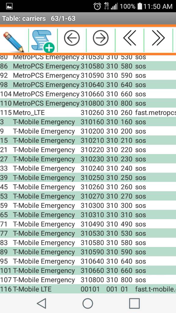

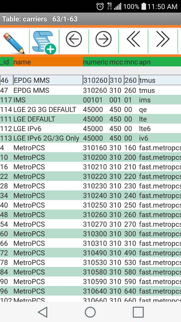

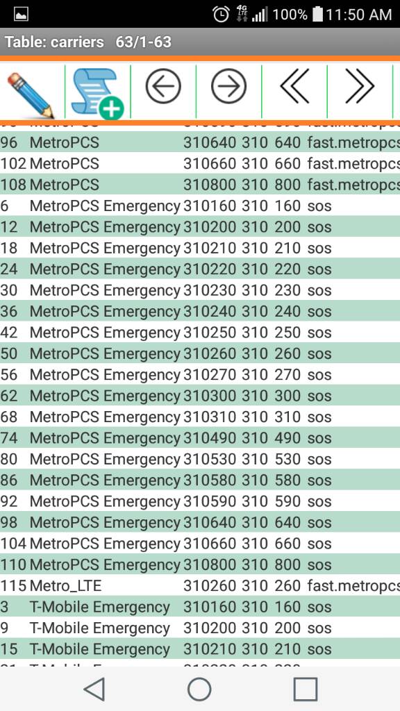

You need to check which mnc area are you in it could be MCC-310 but the mnc_200,210,220,230,240...etc
I appreciate all of this information but how would one edit these fields, they are greyed out. I guess just search for these settings on the MetroPCS network based upon my location? Thanks!
I have browsed this URL previously and discovered this information:
https://en.wikipedia.org/wiki/List_of_mobile_network_codes_in_the_United_States
660 Metro PCS LTE network, shared between T-Mobile USA and MetroPCS customers
So MCC for Metro PCS and MNC for T-Mobile?
What a pain in the neck this has become.... :-\
And how might one go about inputting this information?
