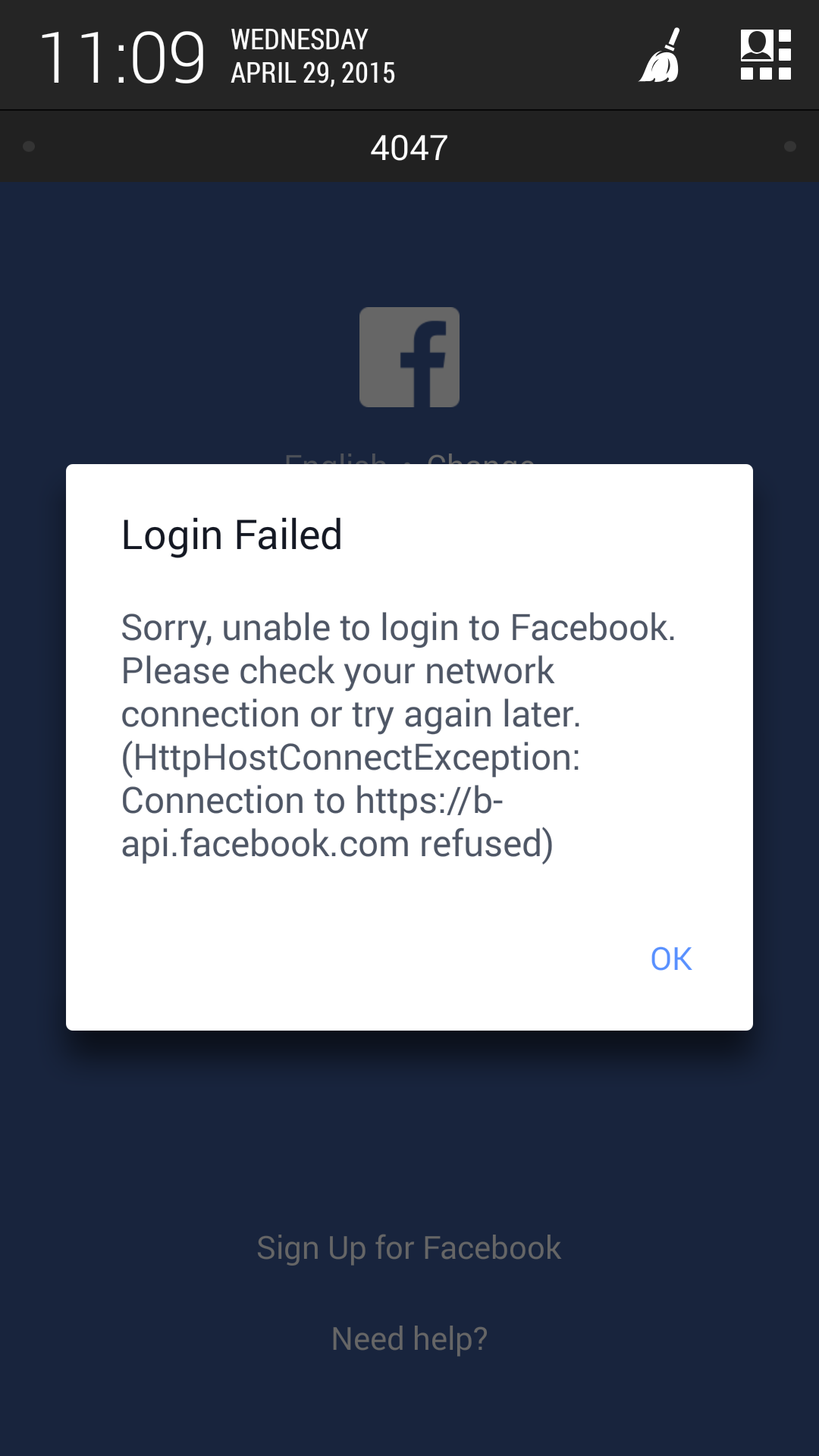

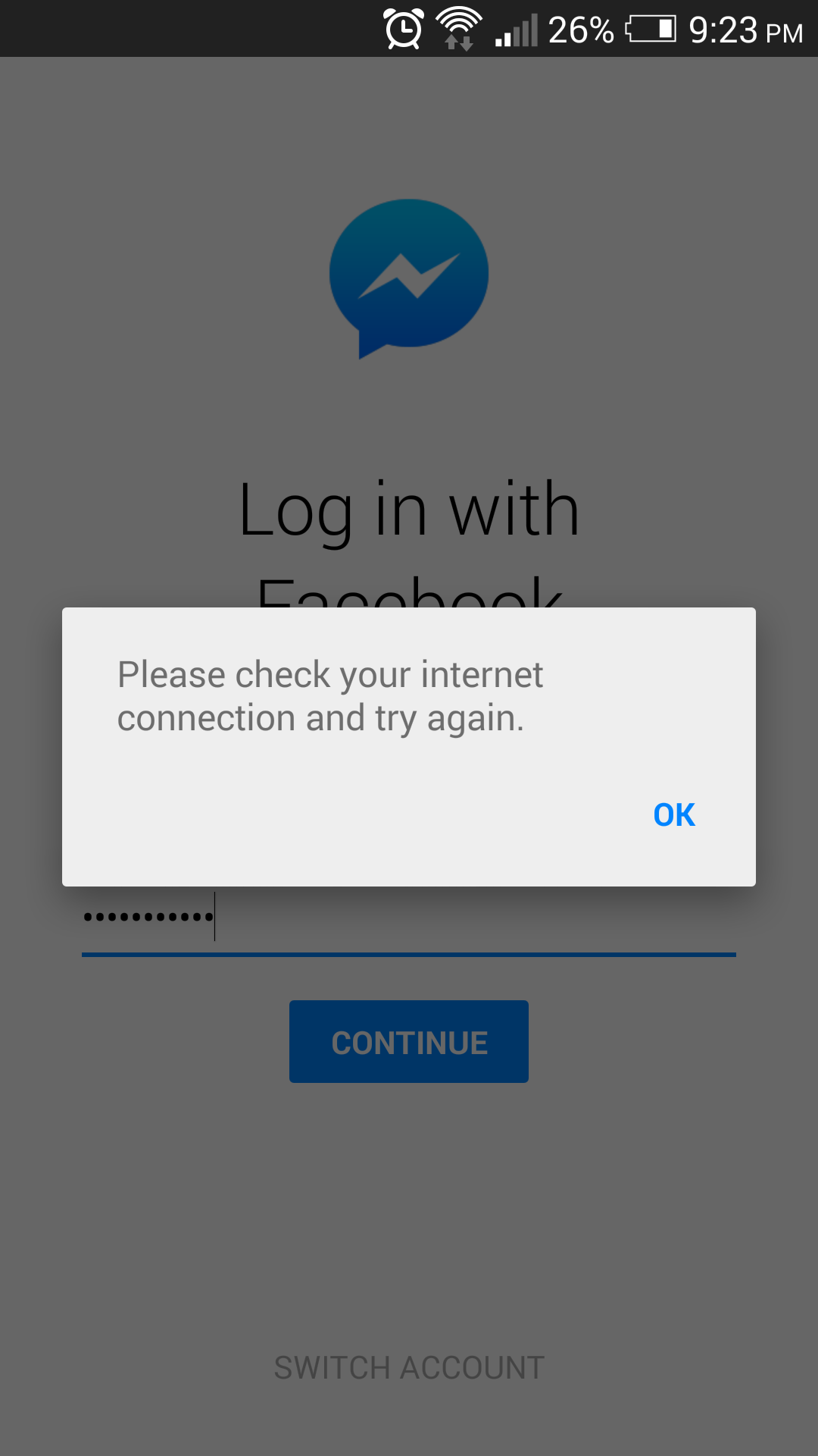

"HttpHostconnectException:connection to http://api.facbook.com refused "
I HAVE UNINSTALL FACEBOOK AND FACEBOOK MESSENGER MANY TIME.
I HAVE RESET MY PHONE .
IN MOBILE DATA AND WIFI BOTH TIME SAME ERROR COMING IN MY MOBILE.
Help needed.
