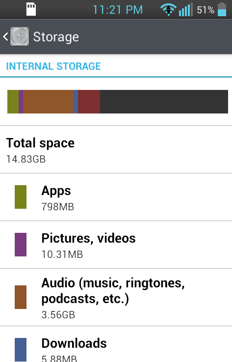

PROOF:

Fat32. Until now I've been using link2sd with no issues.
Is partitioned right? Maybe delete the partitions so it'll just be one. I had mine partitioned and I deleted it before I did this. Other than that, I don't know what to say.

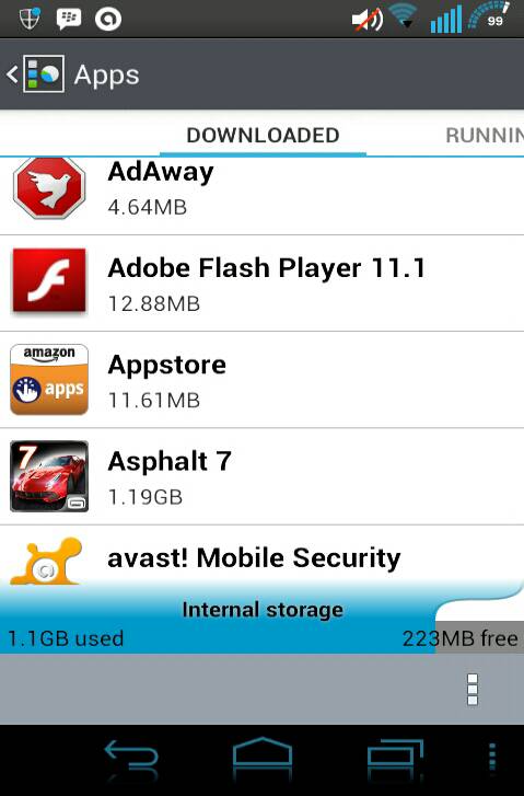

I've completed steps 1-13 without a hitch. But what do we do next? Are any apps installed at this point automatically installed to the external SD card? (If I go to Settings > Apps, it still says that I have something like 200MB internal storage. Then I installed an app and it says I have 172MB remaining...) Am I doing something wrong?

Hmm. So I erased my micro SD card, deleted the partitions, and reformatted (as FAT32). Redid steps #1-13 just to make sure. Now when I go to Settings > Storage, I can see that under "internal storage" the capacity of the SD card (16GB, but some ~15GB actually available) is listed. But when I go to Settings > Apps, at the bottom of the screen I am still seeing the F3's pitiful internal storage listed (e.g., ~200MB free, 1.1GB used).

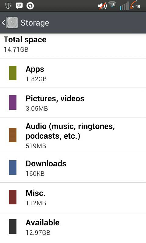

This is weird. I thought that this mod was supposed to swap internal for external and vice versa. But if I go to Settings > Storage, then I do see 16GB under "internal storage". However right below that under "SD card" I also see 16GB. What am I doing wrong? I really, really, really want this mod to work :)
Same for me. But look. I have asphalt and that takes up a lot of space.

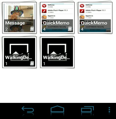

Seems like files are duplicated. I took one picture. Rebooted. Then there were two copies, one on SD card and the other on internal.

Not sure. I deleted the ones that were supposedly on the internal, rebooted. Both copies just show a broken image.
