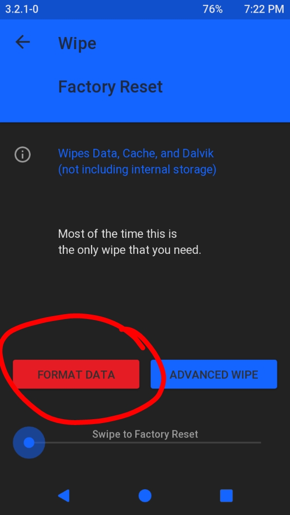

how do I know what to format? once it's formated I will have to install a rom correct because everthing will be wiped? and will the format have to be done in fast boot? or Twrp ounce I re flash it?
Boot to TWRP, click wipe, click the big red format data button and reboot recovery. It will not erase your rom, only your apps that aren't system apps and all data from all apps on your phone along with what is on internal storage like pictures and stuff. All this should be in the op of this thread or found in a link in the op.
