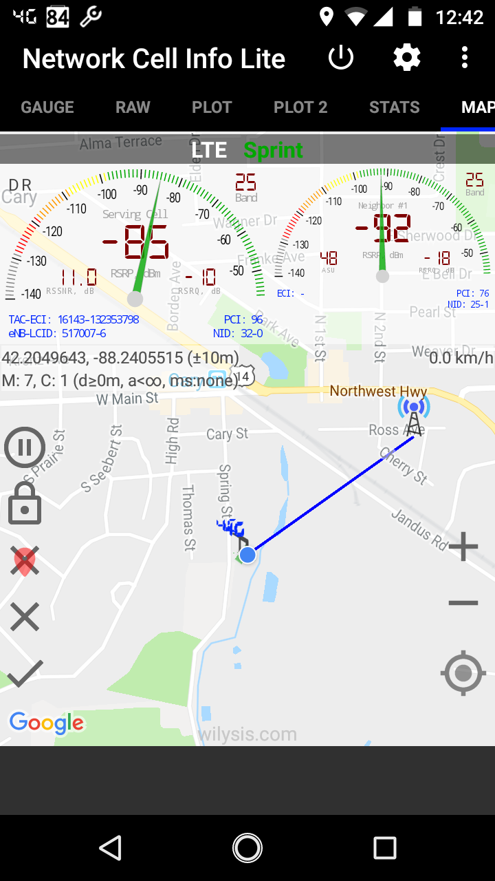

just out of curiosity today I noticed my cell service sucked actully got a no single in my basement , even though it rained a lot and ran a single meter app showed it was poor and I'm hooking up to a cell tower in the next town, odd, and would Twrp have anything to do with it i'm still on the same rom and install adaway and Magisk that should make no difference right ? the phone was full updated OTA before I did this
TWRP definitely has nothing to do with your cell signal. I can tell you though that I have had a horrible signal the last 4 or 5 days or so. My phone was normally on LTE all the time and lately is mostly on 3G, and really slow. It keeps going back to LTE briefly, then back to 3G and sometimes I lose my connection completely in the process. It's happening to me on the latest stock and AEX.
Twrp sits in its own partition, won't interfere.. I've been noticing signal differences that are unusual as well but isn't a consistent issue, so I think it's likely related to the atmosphere, environment, or tower itself.
Edit: maybe flash an older modem and see where ya sit
That's probably all it is, although I think it was around the same day they repealed the net neutrality when I started having problems which makes me a little suspicious. Even though I'm in NY and shouldn't be effected by it yet anyway, it wouldn't surprise me if they weren't pulling some crap anyway.
Edit: I tried all three modems I have and had the same with all of them.
That's probably all it is, although I think it was around the same day they repealed the net neutrality when I started having problems which makes me a little suspicious..
Y'know, you may have something there too. Possibly a combination of both..
this handy program info cell lite showed me a tower was down or getting maintenance and now I have my normal single
