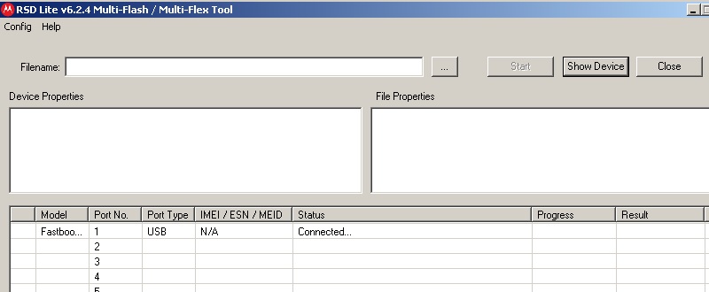

Thanks. I now have RSDLite6.2.4.msi. But - and I'm sorry - could you tell me exactly what to do with it?
Open RSDlite and connect phone to pc in fastboot mode and see if your device is detected. If yes, choose file and see if you can locate one of the XML files and hit start.

Actually, I don't think RSDLite IS seeing my phone (I just saw the word 'connected' but no actual phone details are shown). How to fix this?
