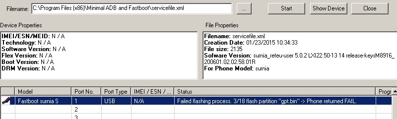

Helps if I highlight the line. All those N/A's aren't promising...

Looking at your pc screen shot shows normal for Motorola devices connected to RSD Lite with it in fastboot mode.
Try connecting again and click on the box with the 3 horizontal dots next to file and see if you can locate either the Flash XML or Service XML for the firmware you downloaded.

I've copied your suggested firmware into my C/progfiles/Minimal ADB & Fastboot. (Copy/Replace all same-name files). First cmd still failing. Both new xml files still failing with RSD.
