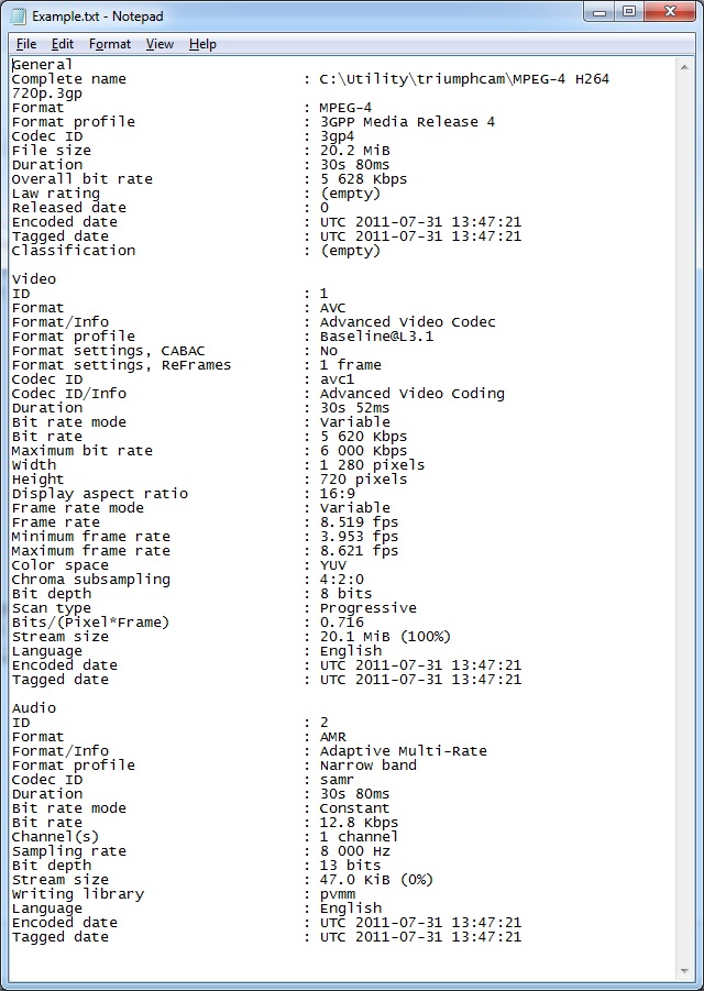

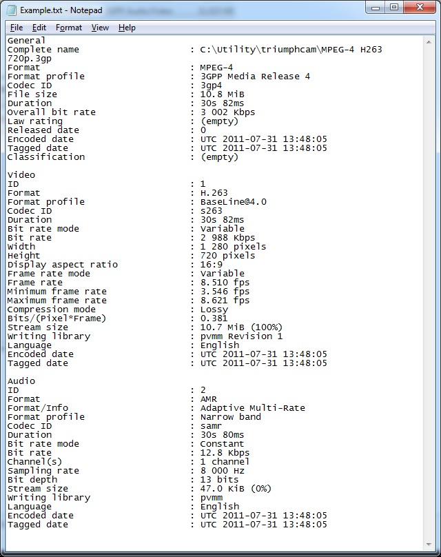

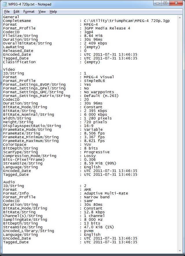

I ran a few quick video tests this morning. Phone was stationary to try and minimize encoding CPU stress on device. The camcorder recording options are mentioned below, testing the Straight Mpeg-4, H263, and H264 encoders individually.
A few other things to note:
Using a class 4 16GB off-brand memory card, however it's tested capable at writes between 2.5 and 4MB/sec. Because the files are recording at a rate significantly less than this, I don't believe micro-SD card speed is the limiting factor.
Switch Camera = Main Camera
Color Effect = none
Video Quality = 720p
Video Encoder = (varies, all three results shown)
Video Duration = 30 seconds MMS
White Balance = Auto
The results are attached in JPEG images, I guess it's worth noting that the devices maximum framerate never exceeds 9 frames per second, which probably isn't very good. Perhaps someone with additional knowledge can add to this discussion. The video file attributes were fetched with a program called "MediaInfo."

Okay, so I just ran some more tests, using every single Video Quality from 720p to QCIF, and this camcorder's max framerate at any setting, any resolution, never exceeds 8.621 frames per second. I don't know what's limiting it, if it's hardware we're stuck ... perhaps there is some Market download alternate for camcorder?
