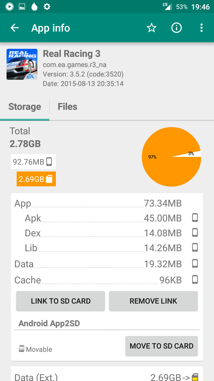

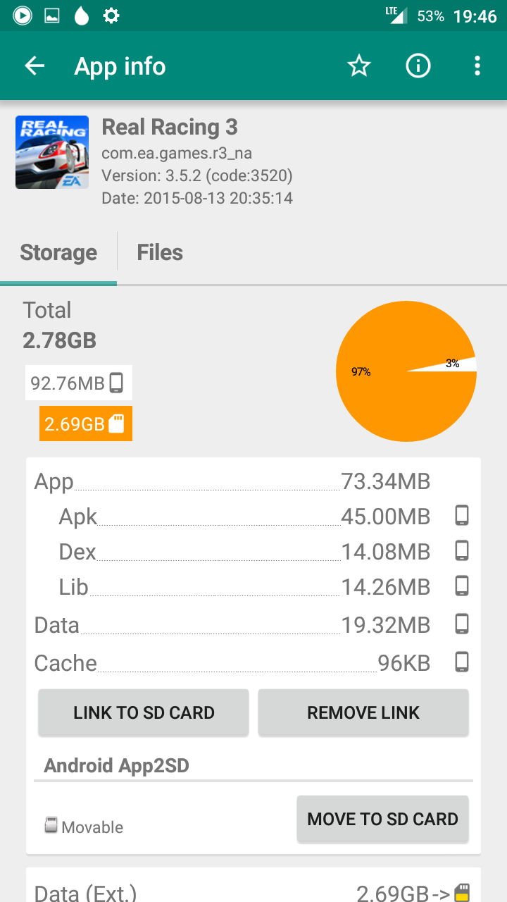

So, does this pie graph mean I've already filled up my 12gig partition with this 2.69 gigs of data? Oh.. No I think it just means that 97% of the game is linked... Lol.
