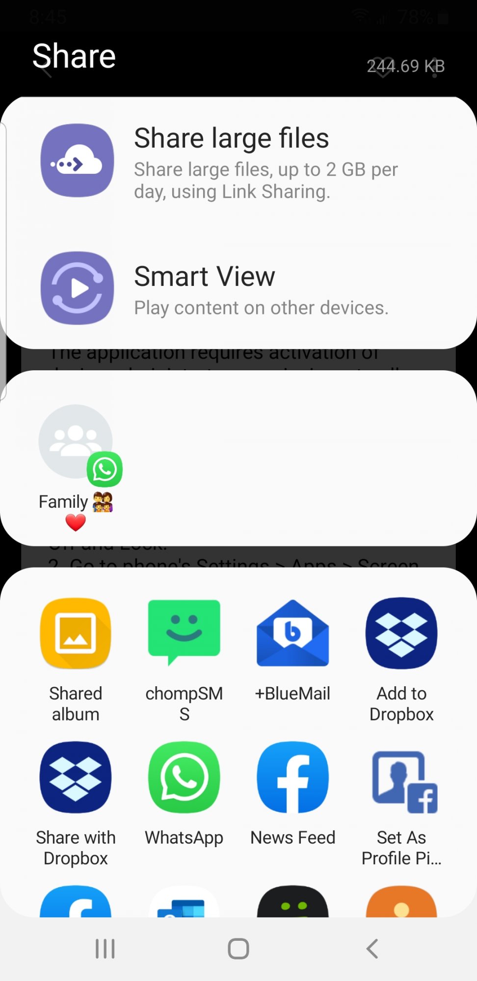

I usually do a factory reset once a month
