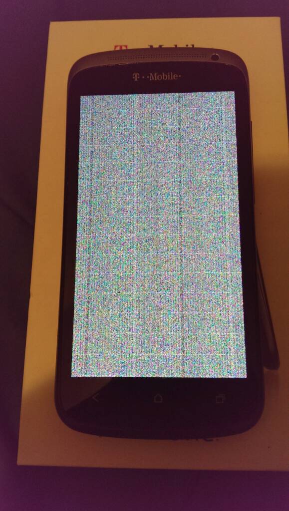

ok i had this htc one s for 2 years and its been frozed for months! a emulator frozed my sceen and it will never go away. i can hear noises when i press the volume and when it turns on but it always show the glitch screen. Factory resetting the phone wont work as i tried it 100 times.i can't get to the restore menu because it always shows that glitch screen. all i know is that my 16gb htc one s had low memory and when i went to lauch a psp emulator aka "ppsspp" it glitched my screen. the screen goes black and makes a sound while turned on but it turns to that glich screen after the black screen. i went to a phone store and they told me that it might be a hardware defect :( i hope i can get any help with this because i just got the new htc one and im thinking about throwing away the htc one s if its not much of use.

Hello and welcome to the forums. Can I ask was this device rooted . . can it be fixed . hmmmmm try to do a hard reset aka factory data reset it will put the device in the working order as it came from the carrier when u brought it .
No it has never been rooted. I can't reset the phone as I can't see anything because this glitch screen is in the way.

The last 2 possibilities:
1) Have the phone fully reflashed. It's the cheaper option, and will give you the same phone you got out of the box if there are no hardware problems. (It's like a "stronger" reset than a master reset.)
2) Have the motherboard checked (by having a replacement screen plugged in [HTC repair shops will have screens from phones that had other major defects that made them too expensive to repair]). If the motherboard is okay you probably need a new screen. If not you need a new motherboard.
At that point you'll know whether the phone is worth repairing or not. If not, the shop may give you something off on a new phone if you let them keep yours for parts. (Even buttons and cases cost something.)

Yes but the weird thing is that it shows the screen when i use screenshot
.I connected the one s to my laptop and find the screenshot of the the original screen in the screenshot folder. very weird.:confused:
