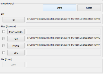

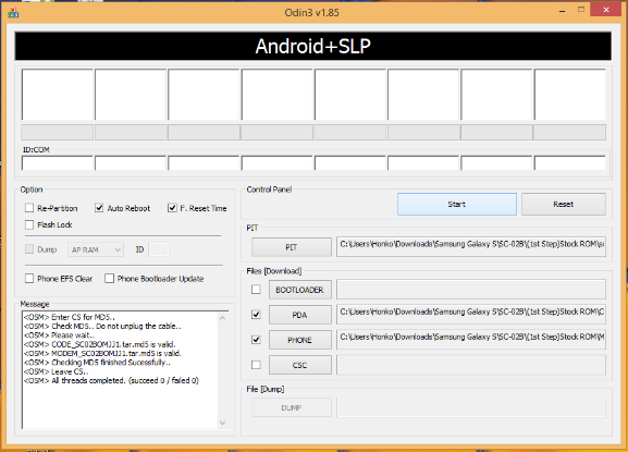

Help Need an instruction to fix my hard bricked samsung galaxy s(SC-02B)
Keep in mind a screen capture will be a lower resolution graphic and may or may not even show all the relevant text. If you post the actual copied text in its entirety, that will then include everything shown in Odin's results.
The reason why I cannot screenshot the not-responding odin,because the computer is also not responding.

Well I agree to that term,but I still don't know why my computer & odin isn't responding when I try to flash.I use Samsung USB Driver For Mobile Phone ver.1.7.23.0 & Odin Ver.1.85.Still can homemade Jig is a good idea to make? Because I worry it will damage my phone.

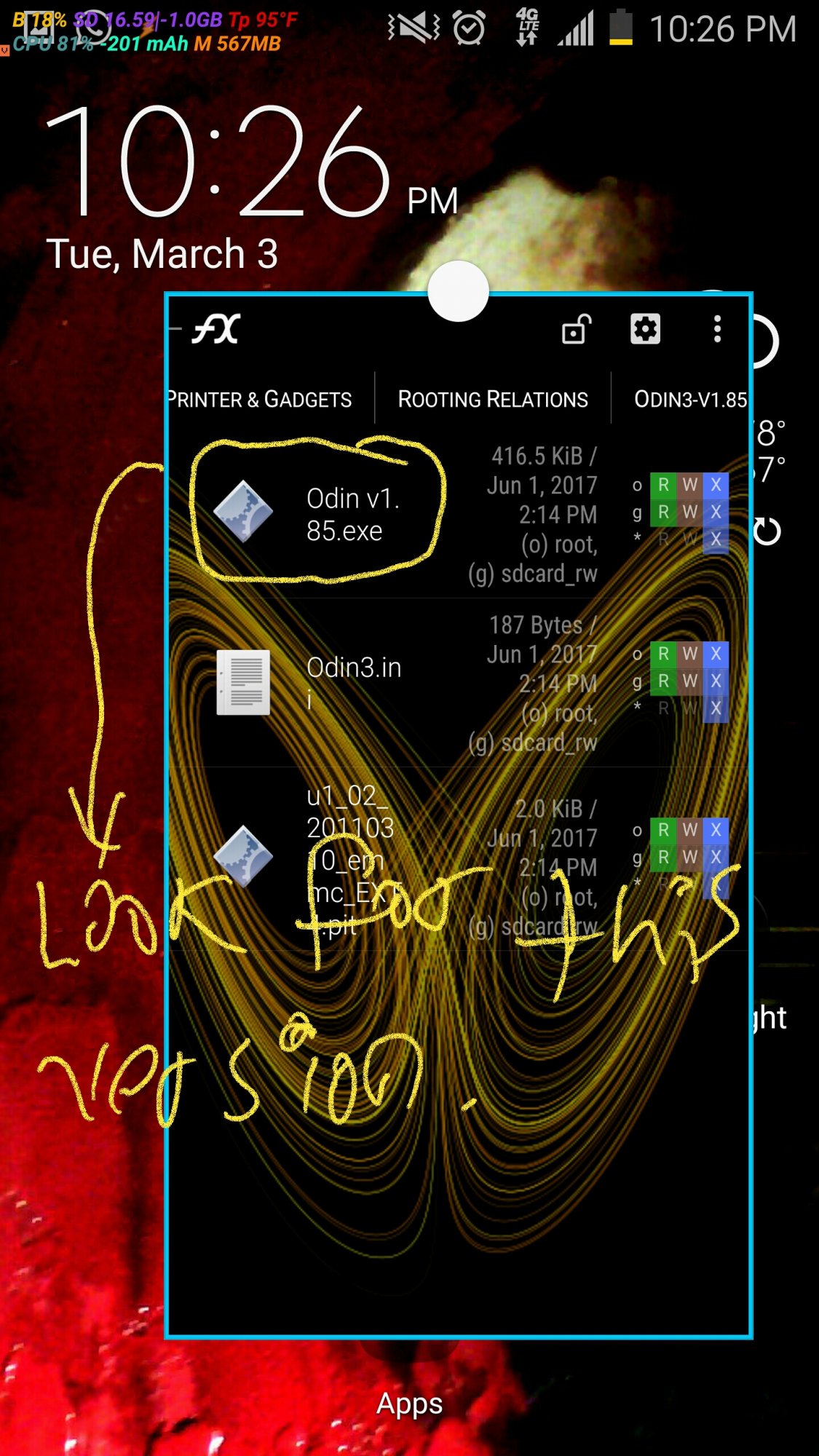

Listen Victor..I think you are odiming with a higher version..I don't know every ones case..but in my case every times I try odim with a higher version it never recognises my phone..I keep this lower version of odim that has never fail me..
If it works you might have a chance of fixing your phone..

I may be mistaken but if your device is unable to go into download mode that would explain the Odin message
<osm> "all threads completed, (success 0 / failed 0)".
I am not familiar with Odin+SLP but all the Odin's I've used have an color indicated to desplay your device has been recognized (uper left side).
Yes I was unable to go into download mode,am I still able to fix this?
To be honest with you, I don't see how it will be possible to flash the official firmware without enabling download mode. Whether, your pc, Odin, drives or usb cable are malfunctioning or not.
