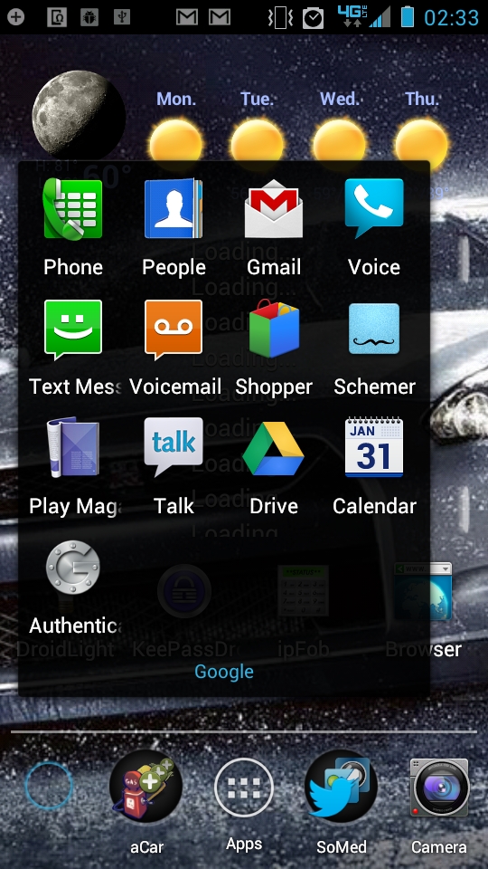

Actually, Satires, this is also in Nova and Apex - and it is a default feature of ICS in general.
See pic:
I thought it was a launcher specific thing too the first time I saw it.
