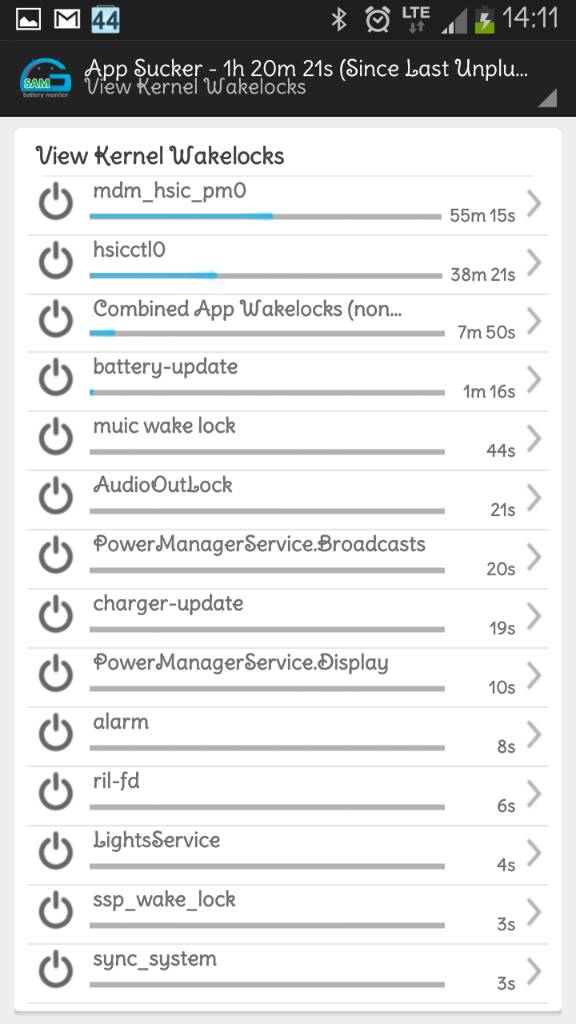

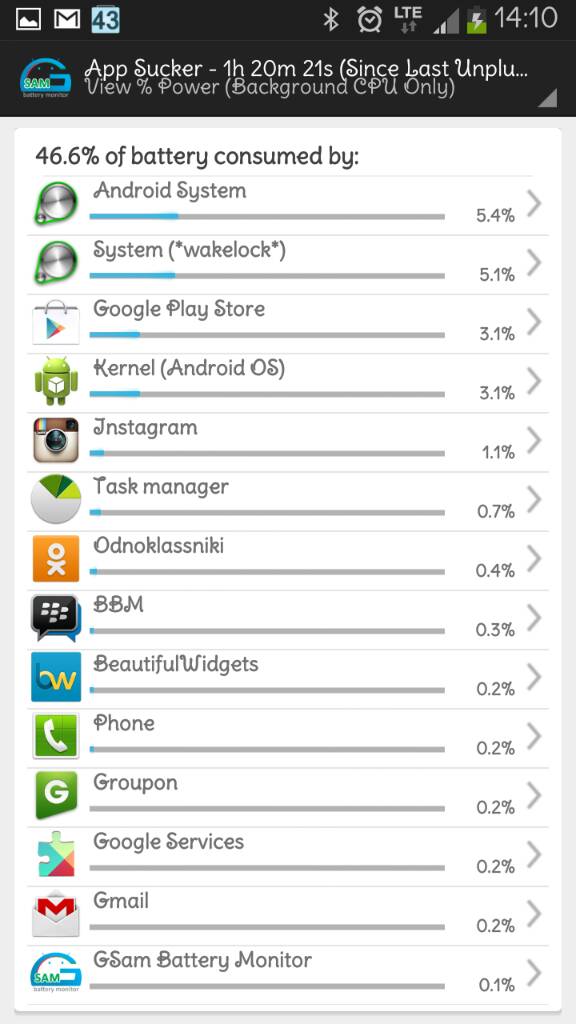

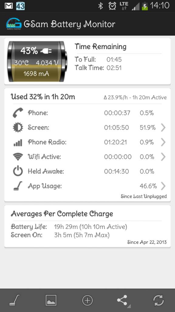

I uploaded a couple screen shots...it doesnt give me a good idea what actually drains my battery. I used clash of clans for like 20mins in total today as I do every day...

Yeah, those 2 kernel wakelocks listed on the far right screenshot may be the issue but I'm no expert.. I don't even know what they are.

I'm not ruling it out, but looking at your wake lock log, I would tend to want to blame an app of some sort on your poor battery life instead of a bad battery. Have you tried running the phone in safe mode? If not, I would reboot into safe mode right after taking it off the charger and let it run for a while and see if you see a difference. If you do, then you have the ominous task of determining which app is causing your wake lock issues. To boot the phone into safe mode, completely power off the phone, press the power button (to power on the phone) and when you feel the very first small vibration immediately begin to rapidly tap the menu softkey (left of the home key.) If you have successfully made it into safe mode, there will be a small safe mode indicator at the bottom of the unlock screen. In safe mode, you can use any app that came preinstalled on the phone. The apps that you added will not be available. Allow the phone to run in safe mode for a few hours to see what your battery life is like. If the drain is gone, then its time to troubleshoot. Honestly, if you have no drain in safe mode, I would do a factory reset and be done with it.
