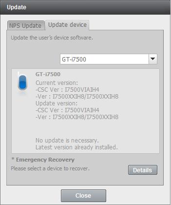

Ironically, the New PC Studio software now recognises the phone :)
