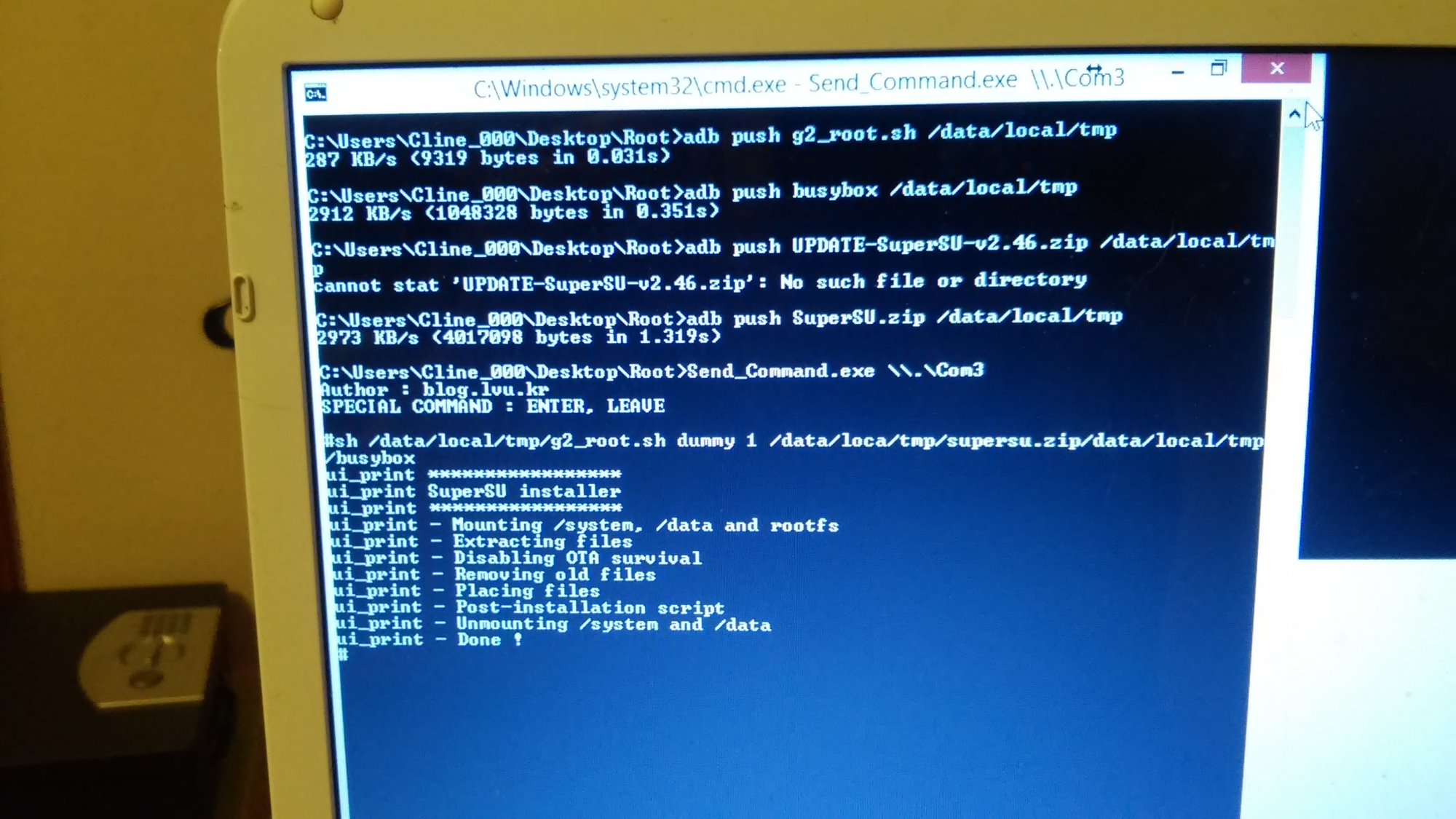

After completing the New Root for ZV5 I recieved this message from SuperSU:
"There is no SU binary installed and SuperSU cannot install it. This is a problem!
If you just upgraded to Android4.3, you need to manually re-root - consult the relevant forums for your device."
LG Volt
Boost Mobile
Model Number: LGLS740
Hardware Version: Rev. 1.1
Android Version: 4.4.2
Kernel Version: 3.4.0+
Build Number: KOT491.LS740ZV5
Software Version: LS740ZV5
The command prompt of it went well and when I started it up in "download mode" it had red letters saying it was rooted. SuperSU is not confirming that though. (Least the phone isn't bricked, everyone and there family is still blowing it up)
LG Volt
Boost Mobile
Looks like it should have worked but I'm wondering if it could be caused by a space being left out of last command? If it wrote SuperSu app it should have written the binary. I'd try the process again and make sure commands are correct. The last one is a bit confusing... I put a ~ where spaces should be
sh ~ /data/local/tmp/g2_root.sh ~ dummy ~ 1 ~ /data/local/tmp/supersu.zip ~ /data/local/tmp/busybox

Well.. I got it to root. Ended up running into another issue. SuperSU didn't install or something, and I have absolutely no idea how to fix it. I copied the code straight from here, was the syntax wrong? Is there even a fix? (the one that used ~ didnt run at all)
