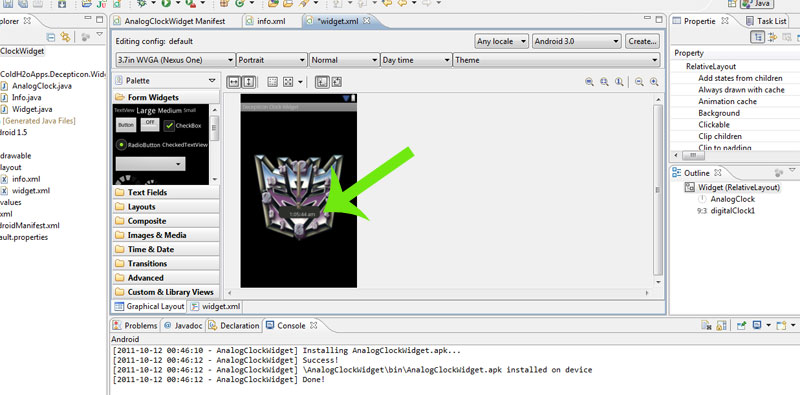

Ok, I am so very thankful to you for offering to help. Here is what I am doing. I am taking the files that you have already seen and loading them into Eclipse. Then I opened the res/layout/widget.xml file. I then loaded up the "Graphical Layout" view and then dragged the "DigitalClock" option on top of my background.
Enclosed is a screenshot of the graphical layout view
The snippit looks like this:
Code:
<?xmlversion="1.0"encoding="utf-8"?>
<RelativeLayoutxmlns:android="http://schemas.android.com/apk/res/android"android:id="@+id/Widget"android:layout_width="fill_parent"android:layout_height="fill_parent"android:gravity="center">
<AnalogClockandroid:id="@+id/AnalogClock"android:layout_width="wrap_content"android:layout_height="wrap_content"android:dial="@drawable/widgetdial"android:hand_hour="@drawable/widgethour"android:hand_minute="@drawable/widgetminute"/>
<DigitalClockandroid:layout_width="wrap_content"android:layout_height="wrap_content"android:id="@+id/digitalClock1"android:text="DigitalClock"android:layout_alignBottom="@+id/AnalogClock"android:layout_centerHorizontal="true"android:layout_marginBottom="101dp"></DigitalClock>
</RelativeLayout>
Then when I try to test my app it shows a grayed box wherever I put the widget on the homescreen and it says "Problem loading widget." If I go back into Eclipse and remove the DigitalClock part and then retest the widget it loads fine.
:confused::confused:
Once again, thank you for taking the time to help me. I can't say thank you enough.
The only other issue I am having is, it is supposedly able to launch the alarmclock features when you click on the widget on the homescreen. It works on version 1.6 but if I test the widget on 2.3 or something like that it doesn't do anything when you press the clock??
Thanks again for everything.

Ok..so where do I start... ha.
First, you need to read this: Android Doc Link
For anyone too lazy to click and read, it basically stats which layouts and views you can use with App Widgets.
The reason your project does not work as intended is simply it is not supported by the SDK.
Solution?
You will first need to remove the DigitalClock from the layout. This WILL NOT EVER work. Replace this with an ImageView like the following:
Code:
<?xml version="1.0" encoding="utf-8"?>
<RelativeLayout xmlns:android="http://schemas.android.com/apk/res/android"
        android:id="@+id/widget"
        android:layout_gravity="center">
    <AnalogClock android:id="@+id/AnalogClock"
    <ImageView
      android:id="@+id/digitalclock"
</RelativeLayout>
Get system time
Code:
long epoch = System.currentTimeMillis()/1000;
time = new SimpleDateFormat("MM/dd/yyyy HH:mm:ss").format(new Date(epoch*1000));
Use the buildUpdate function to create a image based on the time
Code:
RemoteViews views = new RemoteViews(getPackageName(), R.layout.widget);
views.setImageViewBitmap(R.id.digitalclock, buildUpdate(time));
Function used above (I even attached the font for you where you can drop it right into the asset folder)
Code:
public Bitmap buildUpdate(String time)
    Bitmap myBitmap = Bitmap.createBitmap(160, 84, Bitmap.Config.ARGB_4444);
    Canvas myCanvas = new Canvas(myBitmap);
    Paint paint = new Paint();
    Typeface clock = Typeface.createFromAsset(this.getAssets(),"Clockopia.ttf");
    paint.setAntiAlias(true);
    paint.setSubpixelText(true);
    paint.setTypeface(clock);
    paint.setStyle(Paint.Style.FILL);
    paint.setColor(Color.WHITE);
    paint.setTextSize(65);
    paint.setTextAlign(Align.CENTER);
    myCanvas.drawText(time, 80, 60, paint);
    return myBitmap;
Now this is NOT the complete answer. What is left is you need to create a service that will update the time. This is a little more complex then just using a AnalogClock so I will let you look up how you can create a service. Most likely you will need to use the @Override(s) onEnabled and onDisabled of the AppWidgetProvider. So when the widget starts... the service starts. Then use the @Override for onUpdate of the AppWidgetProvider which should then tricker an intent to tell the service to get an updated time and recreate the image.
I hope this helps you out and I am sorry I can not just provide a quick solution for you. Maybe some others can shed some insite or if anyone has created a service like this already could share with the community. :)
Good Luck!
