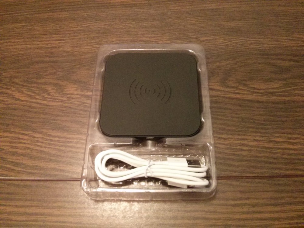

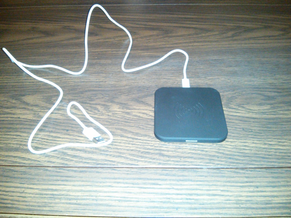

Got my CHOE about 30 min ago, of course I just charged my Nexus...so give me a few days to check it out.
It doesn't come with a wall plug, but I have a spare from my old cell.
