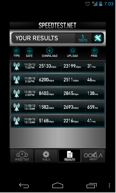

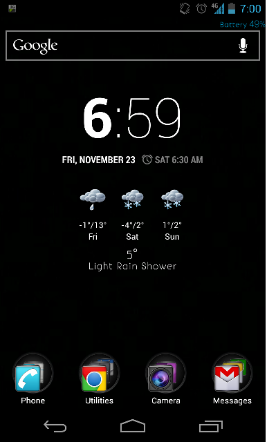

Swapped SIM cards and it worked. Crazy fast...
The bottom 4 speed test are on HSPA. The top one was right after i switched it over.

It's on band 4 people, a frequency which will be supported by T-Mobile when they roll out LTE (coincidence?) Reason #9065 to get this phone on T-Mobile
