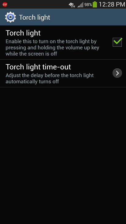

Did you know that the S4 is capable of placing a flashlight widget or app shortcut on your homescreen without having to access an app to activate it each time? And I'm not referring to the built-in 2x1 "Assitive light" widget either. This is a 1x1 widget or normal app shortcut that once configured, can be deleted and will use the volume up & volume down to turn on/off. Read on.
For the widget (there's no advantage to doing it this way

Yes, but Power Toggles (or Widgetsoid) only avoids having the screen clutter. You still have to unlock your screen and swipe down the notication bar to activate the light. The solution I describer lets you activate it by simply long pressing your vol-up button. You don't have to access the screen at all… the only requirement is that the phone be powered on.

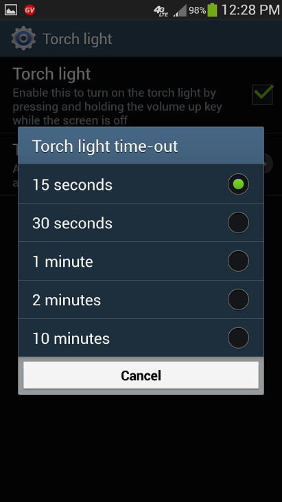

No. You don't have to mess with the screen at all, and once you've gone thru the 1-time setup I described, you simply long-press the volume-up button on the left side of the phone to turn on the light. To turn it off, just tap the volume-down (or let it time-out to whatever you set it to when configuring). Once you go thru the 1-time setup, you don't need to wake up the phone at all… just press the button like a real flashlight.

But you have to push and hold to turn it on, and you can always set a short timeout. I'm not twisting arms trying to persuade anyone… just putting the info out there FWIW. Works for me.

When I saw tbis I thought it would be very useful for exactly the reasons Mr. Lucky sets out. Sadly it didn't work.
I set the shortcut up and the turn torchlight on using long press is ticked but when I long press volume up, nothing happens.
Any ideas?

I added the Torch light shortcut and enabled it and set the 15-sec. timeout. But I can't activate the flashlight. I'm pressing the volume up key while the screen is off and held it for 7 sec. Do I need to hold it longer?

OK...I reinstalled it. On my phone, I have to do a short press followed by a long press to activate the light. After it is turned off, I have to wait at least 15 seconds or so before reusing it. Aside from that, it's great. Thanks!
It also doesn't appear to work if I have a notification I have not reviewed yet (blinking alert LED).
I also confirm the 15 second wait between uses. I wonder if that's tied to the on time selected? (I used 15 seconds).
