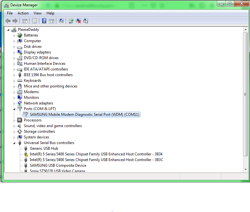

I have installed everything correctly but the device isnt detected by the ADB, it also is shown as SAMSUNG CDMA Technologies under the Devices tab on my Windows PC
i understand, but drivers and anti-virus programs can create communications issues with your pc and phone. it could also just mean that the loop is not allowing for the connection to be complete as well.

This is what is shown in Device Manage by the Ace II X
