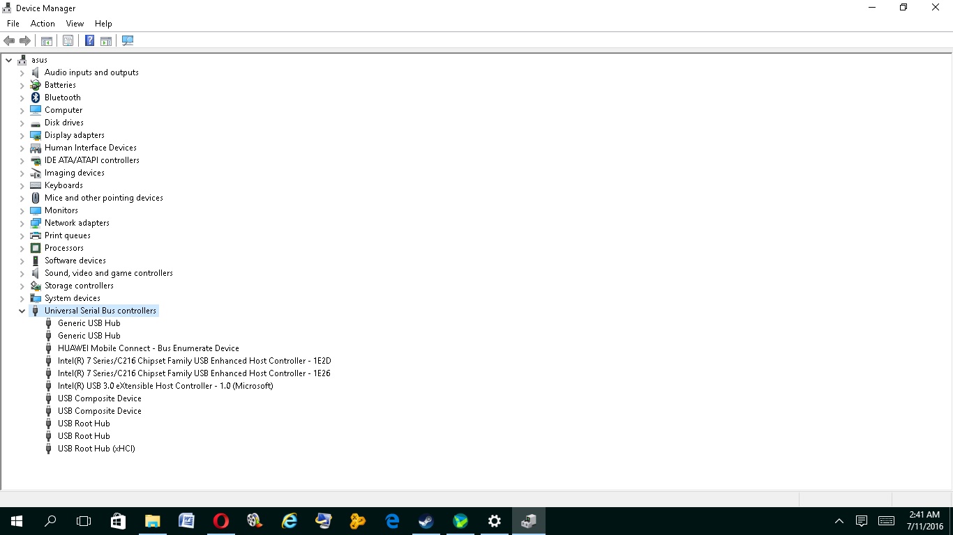

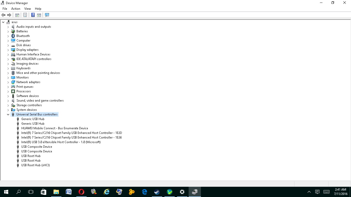

my device is connected but it doesn't display anything here, I also tried the method mentioned previously on the debug option, but still nothing. Help please
