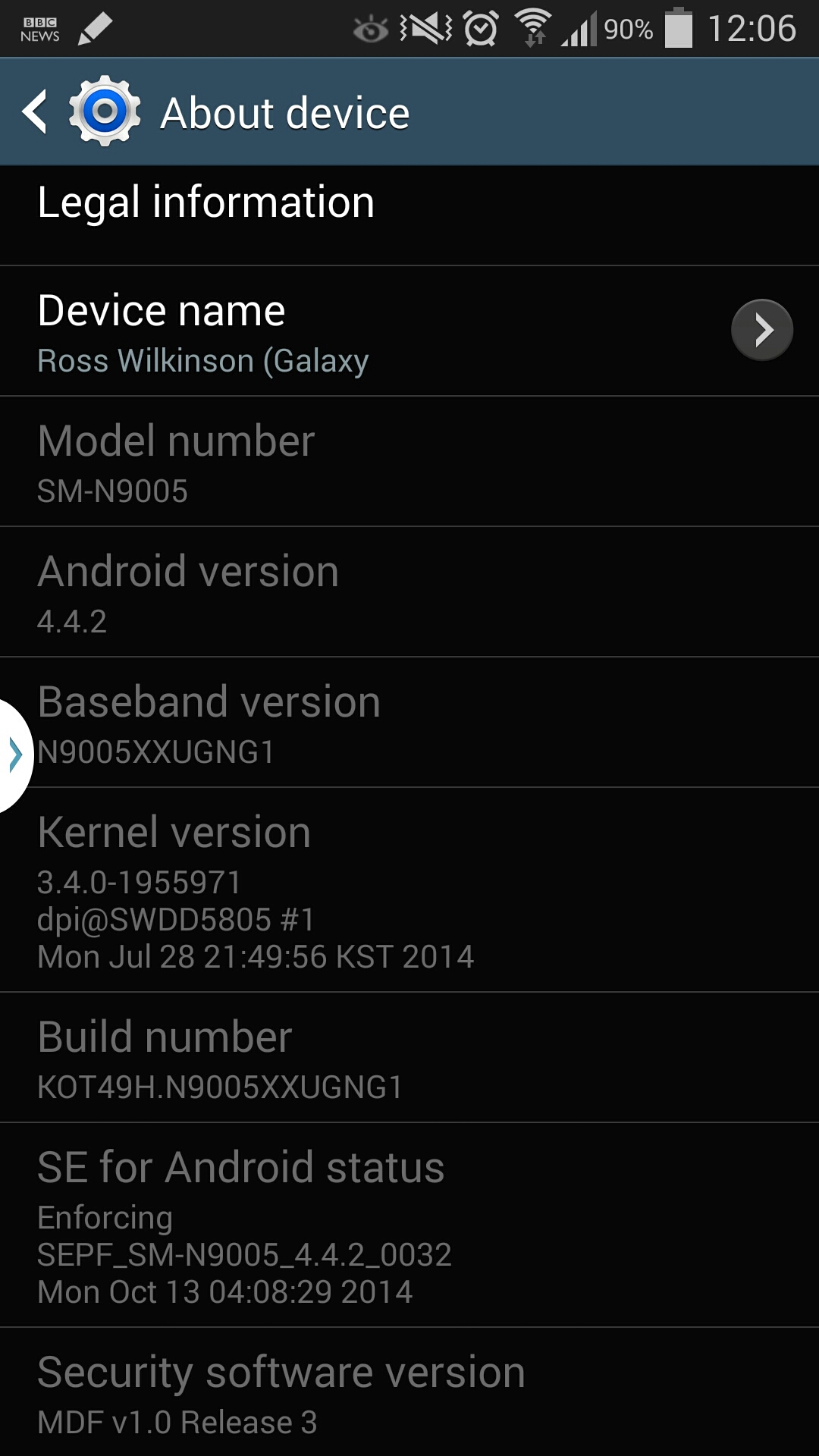

Thanks so much for replying, here are my responses to your questions:
1. I tried dialing #1234# but I got the message 'Connection problem or invalid MMI code'... is there any way to get around this?
2. Screenshot attached - let me know if this is OK
3. Device is brand new
Thanks for all your help - please let me know if you need any more info

Right, from the information provided I can see you have a unbranded British Galaxy Note 3, SM-N9005 the international Qualcomm version running the latest firmware. All good and it was brand new so no danger of it being rooted or messed with.
I suspect a rogue app, but first make sure, as much as you can on the hardware front. Is your battery snugly fitting. Will it stay in with the battery cover off ? Is your SIM card in fully ? All things it could be.
Now, try and think back, have you installed any apps ? If so did your Note 3 have this fault before doing so or after. Take a look at what is using your battery. Screen, Android System & Android OS will be the big users. Are there any apps that use the battery more half the percentage of the lower of these three ? If so it might not be that app, but it will give a good indication of a power hungry, possibly poorly coded coded, one, that could be the culprit. If your at a loss app wise, then run your phone in "safe mode" for perhaps a day or so. This will prove it is not the phone but an app causing problems, from there it would be a matter of unistalling apps one by one until the phone behaves normally, at that point you know it was the last app unistalled. Finally the last thing to try is a factory reset from recovery. This will wipe everything except your media and take the phone to it's "out of the box" state.
I hope you don't have to factory reset, or worse have to ask the online retailer for a new one. I'm fairly confident though you'll sort it. :)
