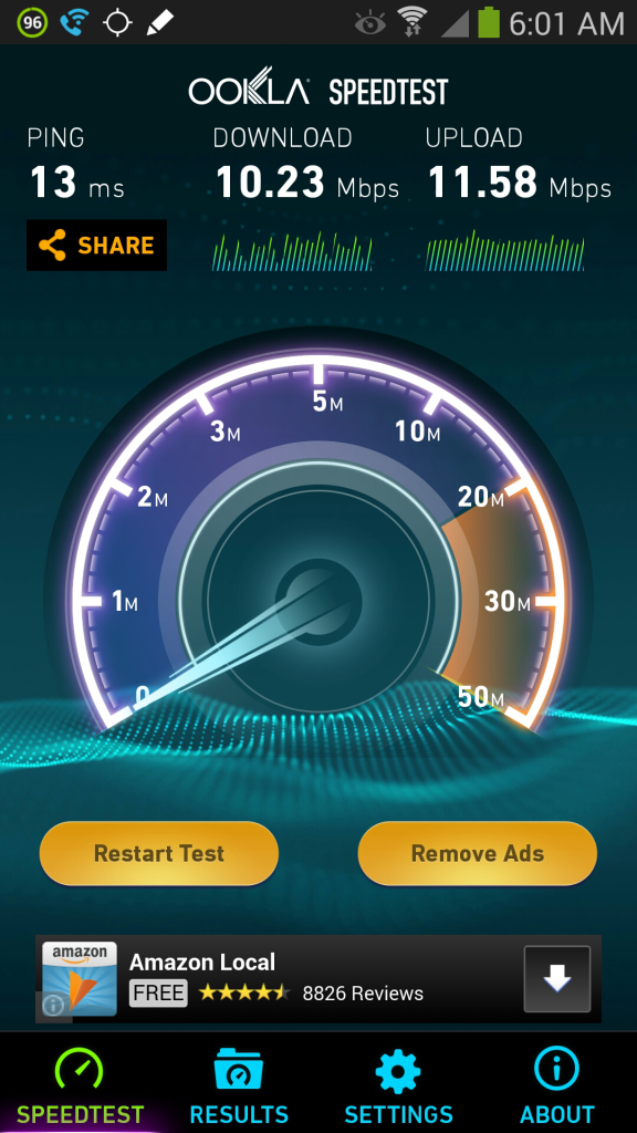

Ok, attached is my speed test... but I think my problem is that the site I was on is Flash based, and even though I installed an old version of the Flash App, the browsers are not recognizing it.

Your home 4g speed is slow, and only one bar. At times you may have none at all. Streaming HD can go up to 12 - 14 mbps. Depends on the source.
