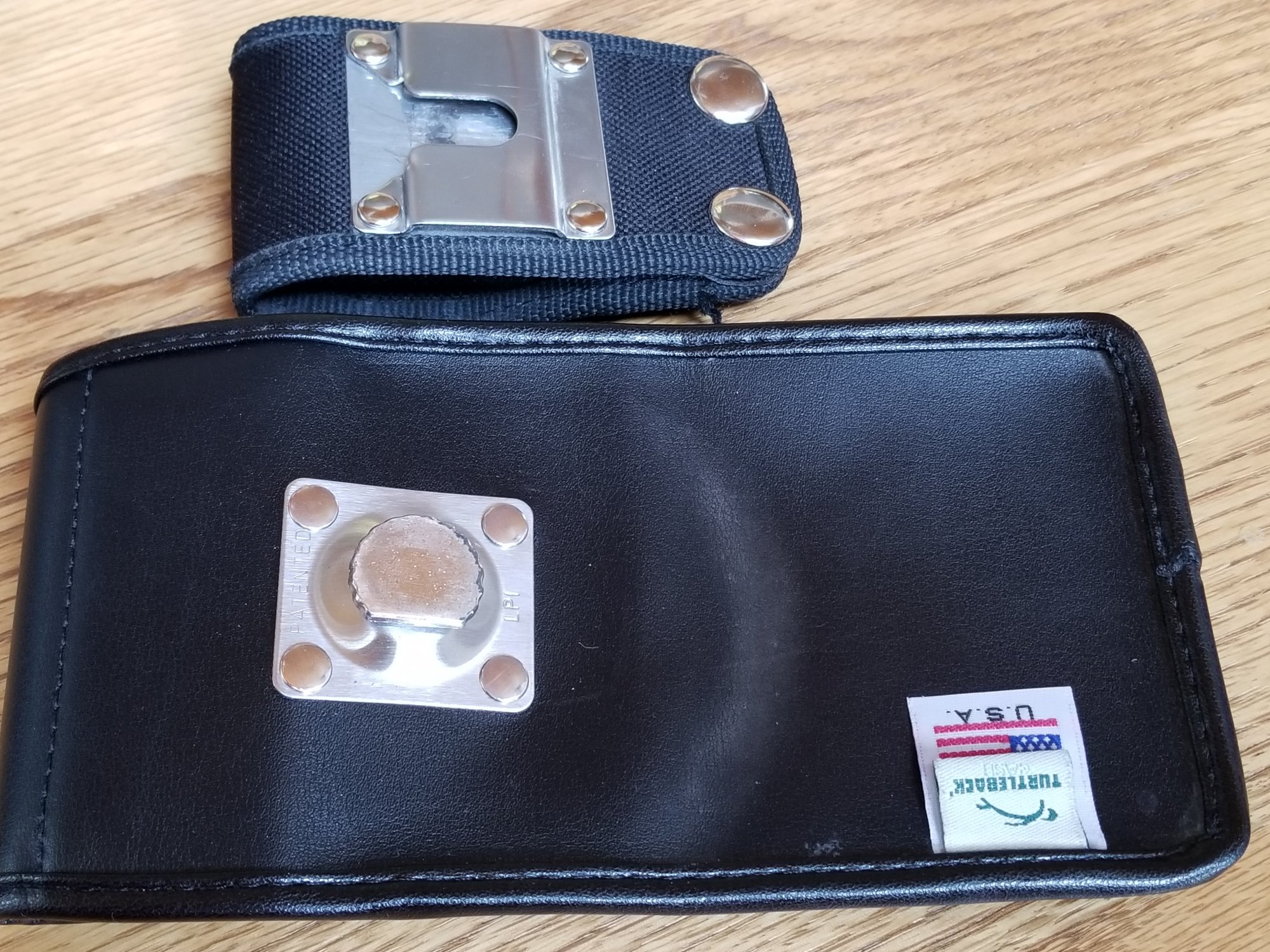

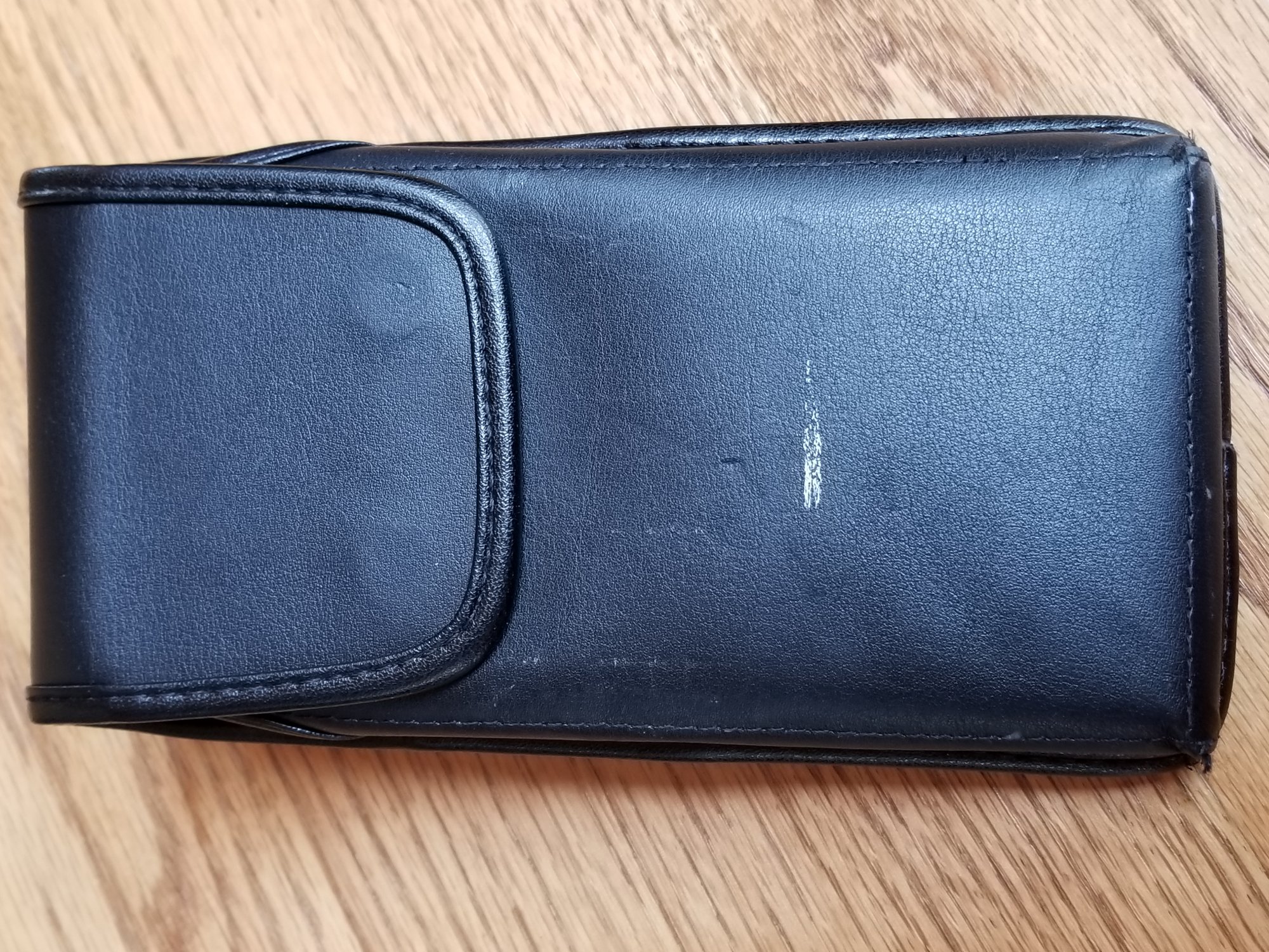

Here is the solution and what I have found was the culprit. It was my holster on my belt which contains magnets to hold the flap closed. These magnets were interfering with an internal sensor on the phone which would make a random noise whenever I walked around. I still cannot reproduce the sound or event. I can only tell you that it has not made the sound when I don’t use the holster. The obvious solution is to get a holster that does not contain magnets and/or metal.
I would love to open the phone and find the exact reason/sensor responsible for this. I would also love to find that exact sound that has drove me and my engineering department completely nuts since the purchase of my new phone. However, these phones are not cheap and I will just have to document my findings for others to benefit from until I get my hands on a sacrificial phone.

The Holster is a leather type case with the flap held closed with two internal magnets. The brand name is Turtleback, Made in the USA. I would place my phone in the case with the screen toward my body and the backside of the phone toward the magnets.
Here is the case in question.

i dont use a case but from experience with smartphones and cases in the past, magnets in cases sometimes CAN cause some issues with phones operation. lots of discussion about various instances avail by searching the WWW.

My unidentifiable notification sound was definitely created by the magnets in the phone holster that I had. After a ridiculous amount of time fiddling with the phone, apps, and even returning the phone for a new one, the exact problem was that the magnets would interfere with an internal sensor as I would walk around at random times.
I have since found a really nice tactic holster (on Amazon) that has a clip closing the flap instead of velcro. It has never made that sound since.
