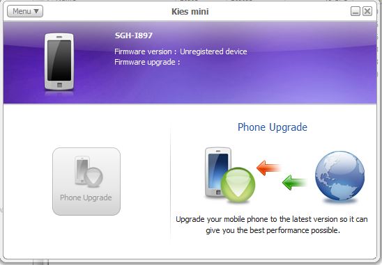

Here is what I got. :(

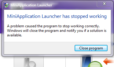

Well, still can't get mini to run past recognizing the phone. It always comes up with this error. I have tried everything I can think of, regular kies does work but would still like this to work for the simplicity of only updates.
Edit: Just read on project voodoo that ext4 has to be disabled for kies to work which is strange because the full version of kies works for me in ext4 mode. Well, at least for contacts, pics, music, not for the update which I know is because of all the mods.
