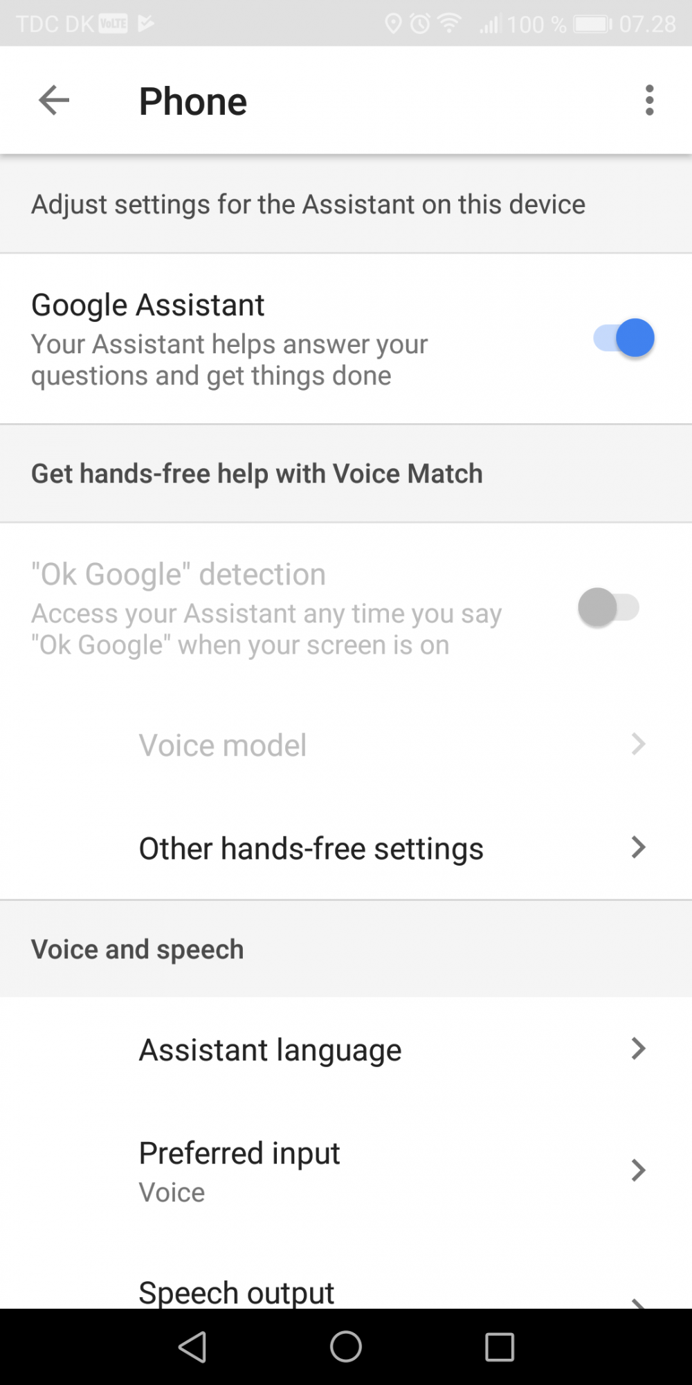

I'm using Huawei mate 10 pro. '' okay Google '' was worked perfectly but something happened and now I can't start '' Okay Google detection''.So that means I only can use''okay Google '' if I press the microphone button. I think after I set my voice for ''okay Emy'' useless voice wake up something happened and now it doesn't allow me to start '' Okay Google detection '' again. Or maybe the reason is something else I really don't know.. Is there someone who has the same problem or can help me somehow?
If you open the Google app on your phone and go to settings>voice>voice match, you can retrain it to recognize "okay Google"
If you open the Google app on your phone and go to settings>voice>voice match, you can retrain it to recognize 'okay Google'
The problem is that the option for that it does not work. I'm not allowed to press it

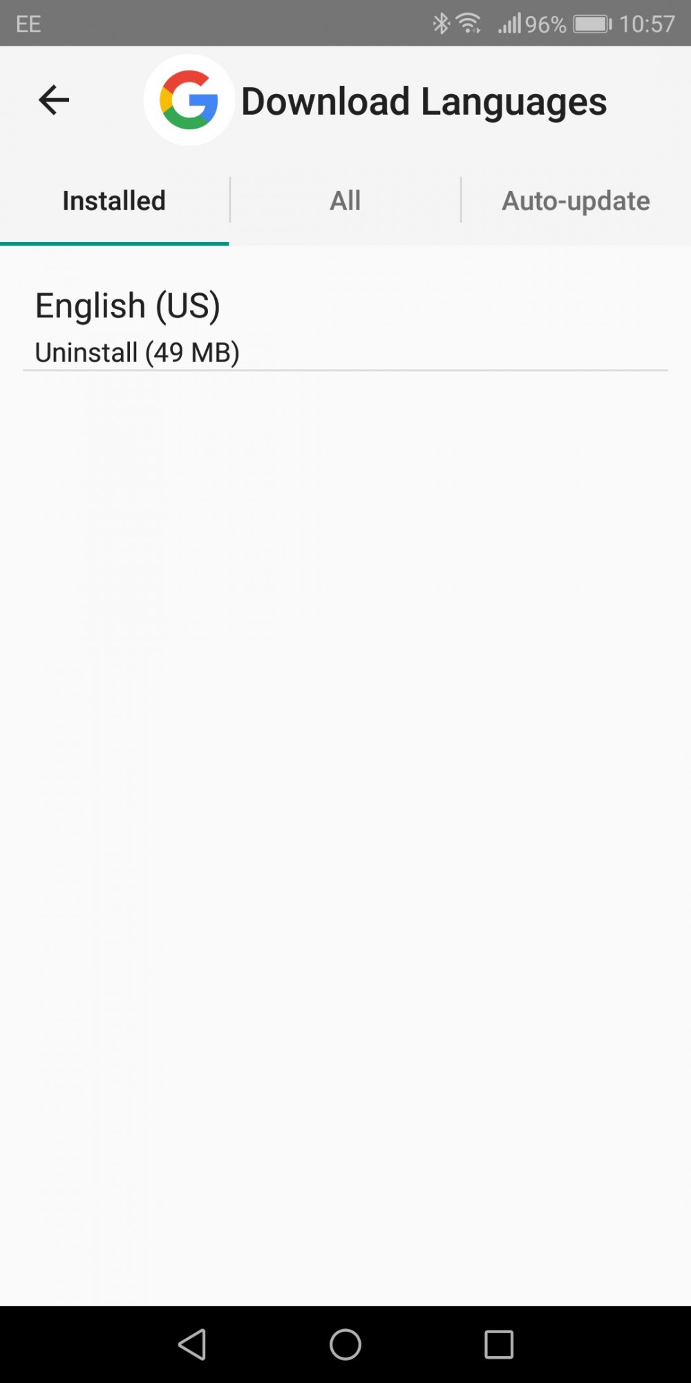

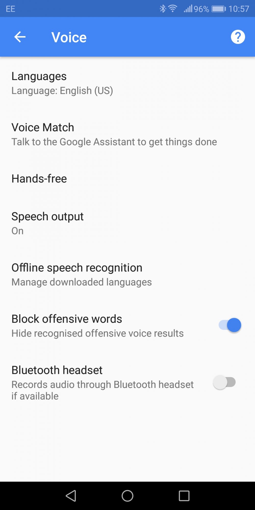

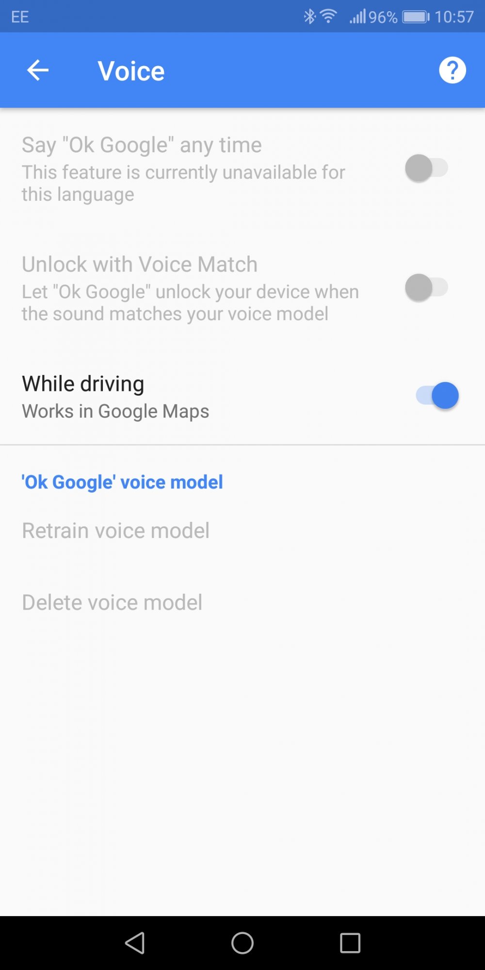

As you can see from the attached images the issue appears to be linked to the language package, all I get is ’This feature is currently unavailable for this language’.
Despite having everything set to English US, I can’t get the sliders to work to enable OK Google.
A factory reset won’t work, as I’ve already tried it twice.
I’ve tried all the solutions suggested above & elsewhere online, but no joy so far.

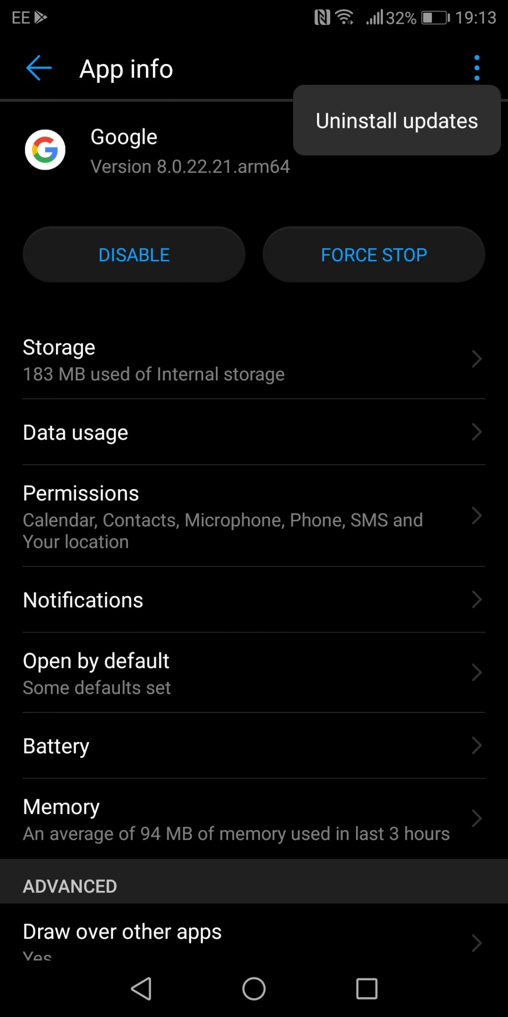

I'm having the same problem after the latest update, it also seems to be affecting voice detection on Android auto (it recognises the voice input but then asks you to click on the notification, but there isn't one). I've tried all suggestions to include a factory reset with no luck. You mentioned that you uninstalled the update, could I ask how you did that please?
I'm having the same problem after the latest update, it also seems to be affecting voice detection on Android auto (it recognises the voice input but asks you to click on the notification, but there isn't one. I've tried all suggestions to include a factory reset with no luck. You mentioned that you uninstalled the update, could I ask how you did that please?
Sure, from settings click on Apps & Notifications, then Apps, scroll down to Google app click on it and then click on the 3 dots in the upper right hand side on the screen - This will give you a button to Uninstall updates
